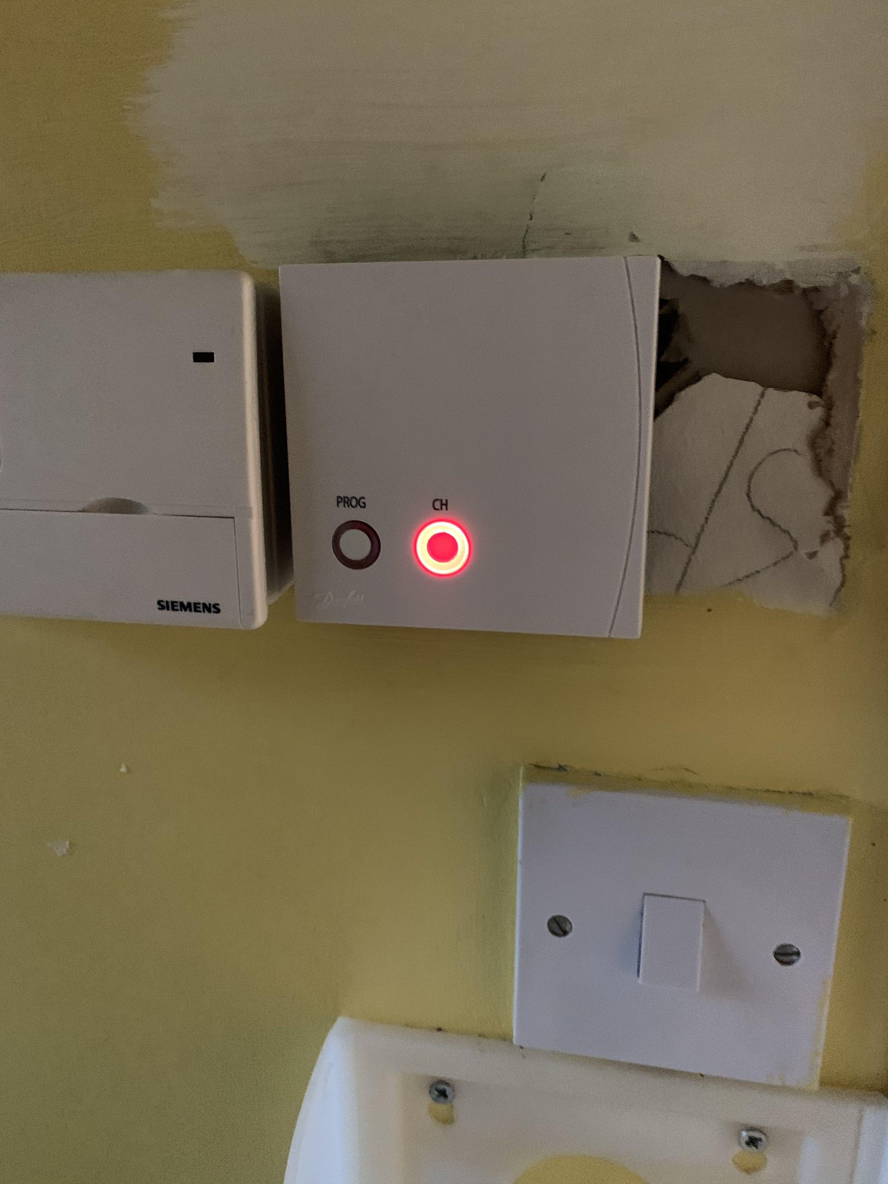

    I have had a new boiler installed, an ideal logic 30k system boiler, with Danfoss rf thermostat RET2000b-rf+rx1-s, wireless. I have had problems with boiler not turning on with thermostat and sometimes not switching off, the installer has now moved the receiver even closer and I am still having problems, the signal sign is showing on thermostat and so is the heat sign. The receiver ch button is on red like it should be but boiler does not come on, today nothing happened for ten minutes so i turned the thermostat to off twice and back up, then it worked.

  2. Husk24
    Husk24 Member
    pixs attached is it helps

    The receiver was about 15 meters away, it should work upto 30 meters but there were a few walls in between and now that has been moved and the distance from receiver to thermostat is roughly 3-4 meters with one wall in between. The receiver lights up when i turn thermostat up, its the boiler that doesn’t turn on when it should do
