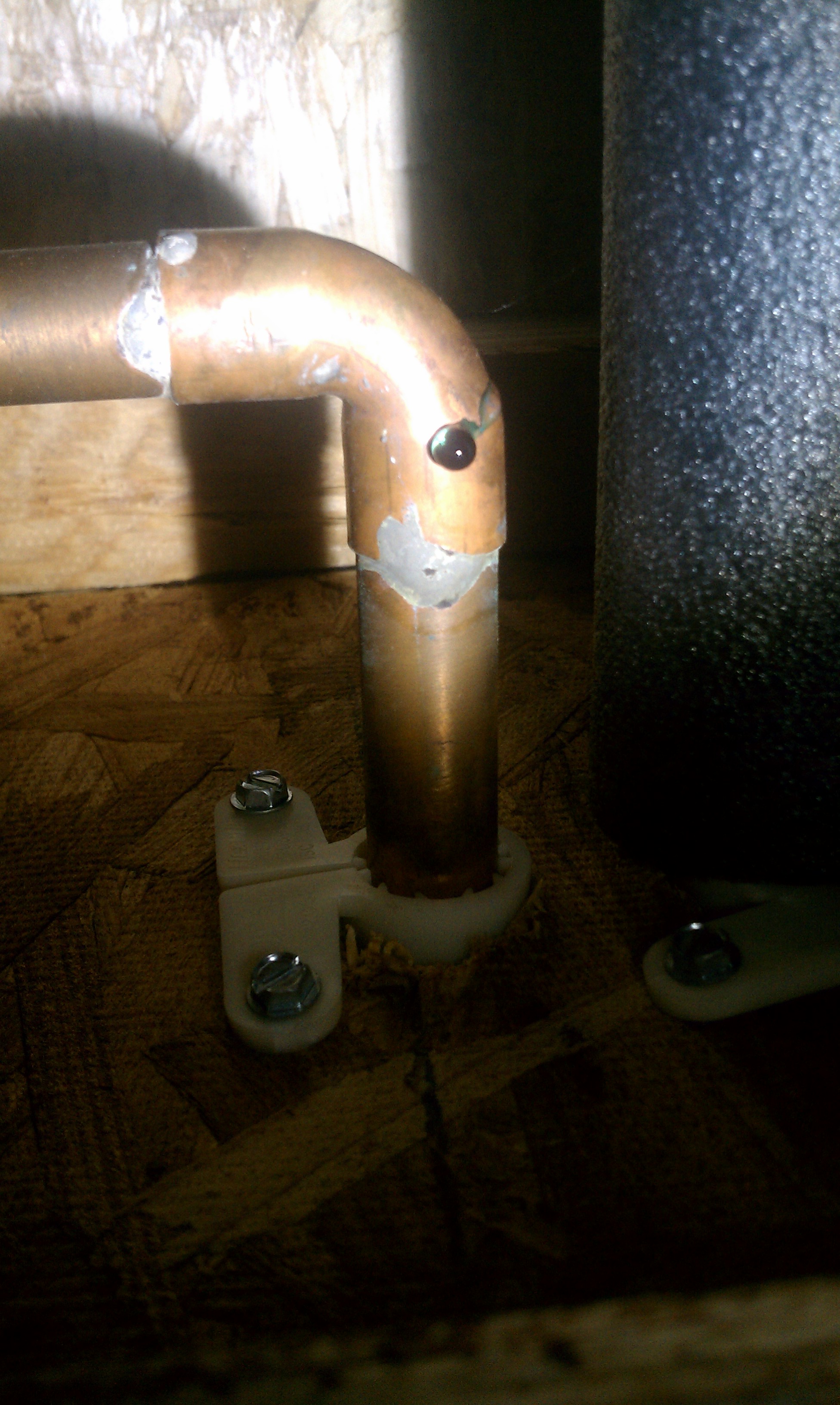

I got called out to a leaking copper central heating return pipe. The customer thought the leak was coming from the soldered joint, but I quickly realised that the copper was pin holed most likely due to acidic flux being left on the pipe.
It takes seconds to wipe off excess flux. Those that don't then the consequences of this are the holes pictured in the pipe below.

The other thing about this pipework, that it could also have corroded from the inside too. If there's that amount of excessive flux on the outside of the pipe, I can only imagine what the inside is like.
Wouldn`t it get flushed away.

No it stays active in the system, but it will eventually degrade over time. It's best to flush it out of new pipework before use.
I had to repipe the cold water services of a whole school cos even mains pressure hadn't flushed it out. It started literally close to the supply and then over a period of weeks got peppered with INTERNAL leaks as dozens of smaller blobs of flux has stuck to the internal walls and been pushed down the pipe. That was the point I switched perm to heat activated flux cos I realised that, with the best will in the world, one could never clean it all out - especial in remedial works.:(
