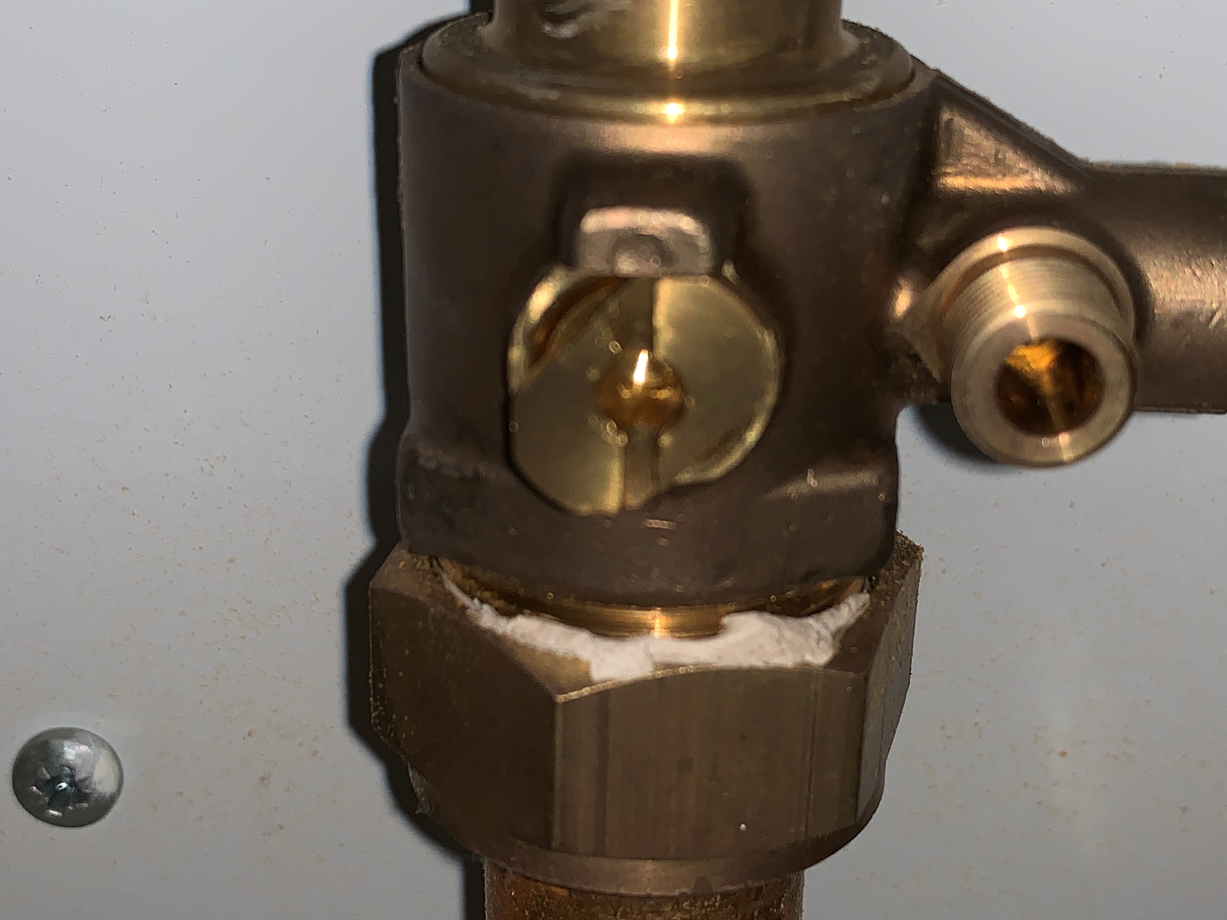

Our boiler water pressure has dropped and I need to refill to get it to work again but the valve on the water inlet pipe is very odd and I can't find a tool or key to turn it.
Does anyone recognize this and know what and where I can get a key?
Any help, much appreciated.

Hex key will fit but will not fill your boiler.
You have been watching the wrong YouTube that was a combi.
You will have a external filling loop as others have stated.
Have you got an F22 ?
If so what you going to top it back up to?
Airing cupboard silver valve
That's it, they both go on untill it's between 1/1.5 bar then BOTH off again.
If the pressure dropped on its own then you've got another fault but topping up will get it running for now

I was surprised to learn that those two taps were the filling loop. As you suggested, opening those has brought the pressure back up to normal range.
Much much appreciated we can have a hot shower again..

Take a quick look around your rads and pipework. See if there are any weeps or drips.
