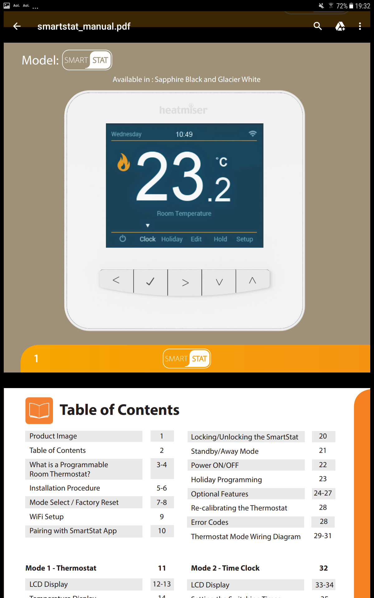

the bedsits are going to be holiday lets and I ideally want to be able to control the heating from a phone app - then I can turn it on before guests arrive and switch it off when the bedsits are vacant. I looked at the Ideal touch connect but sadly you can only connect one thermostat! The Nest ones are too clever (and expensive) for what we need, must be a simpler alternative that just allows you to turn the heating on and control temperature (in multiple zones)?
Heatmiser system you need if wifi it's a must
Just looking at the Heatmiser Neostat, looks like a good option, presumably we can use multiple ones with the one boiler?
Yes probably need there wiring / zone centre as well but yes
Thats great, thanks!
All the bedsits have a small bathroom, open plan living room / kitchen and one bedroom, if we had one centrally located thermostat in each bedsit would that do it?
Yes but if there's a rad in the same room must be non trv controlled
