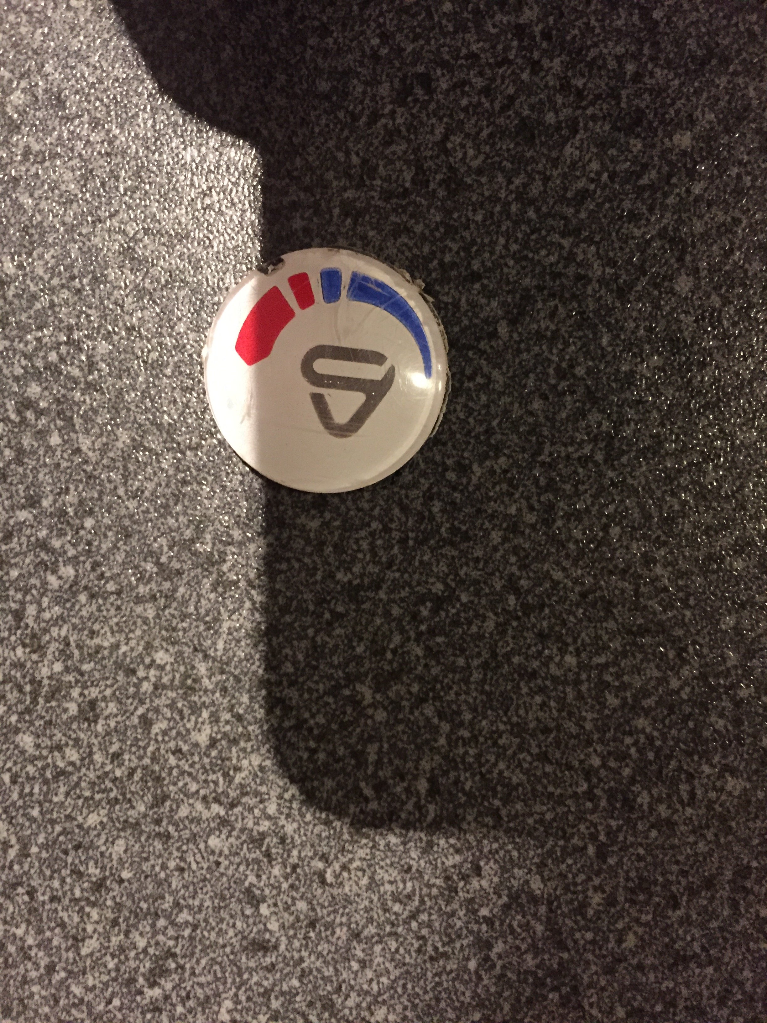

I know, I was pushed for time tonight so didn’t take any photos, the only one I’ve got is of the logo. I’ll attach it to see if you can recognise it? Thanks again.
That logo looks like an A and an S combined, so points to Armitage Shanks, a quick google for armitage shanks logo didn't bring anything like that up though.
A lot of companies rebranded in the 90's and early 00's though so you never know.
Definitely seen that logo before though, will stop thinking about it now and it'll probably come to me while taking a dump, like it does :)
Its a thermostatic sequential tap. Change it. A new cartridge will cost you more than a new pat.
yeah new tap time, you can get a good new tap, including a francis peglar tap, for around £35 and it will just work no messing.
