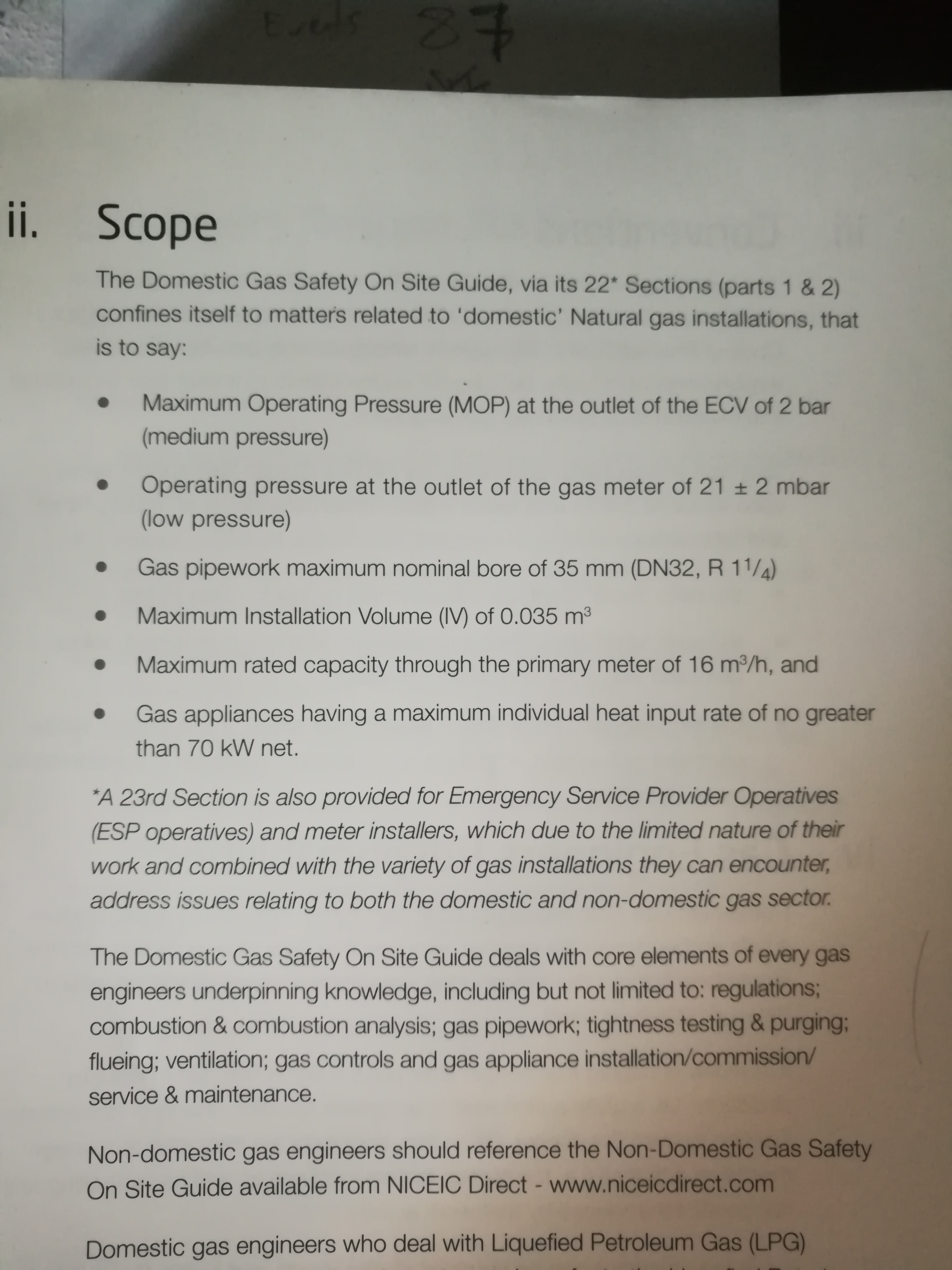

    From this I understand that you can service on appliances that have a maximum individual heat input of 70kw.
    You wont be able to install three 65kw boilers no matter how close they are to the meter because their combined needed m³/h is at 20 meaning the gas meter will be larger than the allowed.
    For even two 70kw boilers you have no chance as using 1m of 35mm pipe would put you at 0.923 mbar loss and that's without the runs to the boilers just where it would Tee to go to them.
