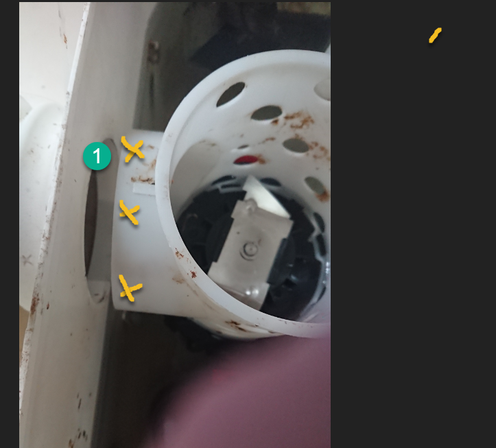

Note that the lid,white ring and black ring were NOT in the Saniflow. They were discarded on the floor. Is that a potential problem?
QUESTION: This new photo shows 3 X's. Should the black ring be positioned there where the X's are?
If so, what holds it in position??

Lid should be fitted, the two rings are not so important, black ring stretches over cage where X`s are but not important if it doesn`t.
