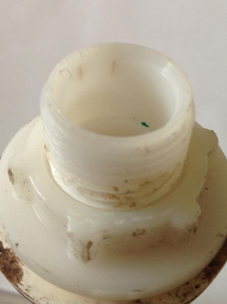

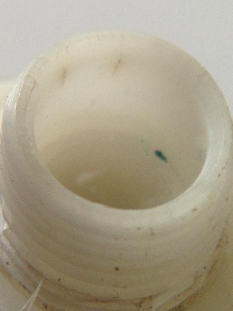

Went to bung water off on a cwt in attic of a modern posh house and discovered water everywhere around tank and ceiling. Fluidmaster plastic tailed side entry valve, (which I then replaced with brass tailed Pro version) was leaking at end of tail. Close inspection shows the plastic has cracked in 2 places
