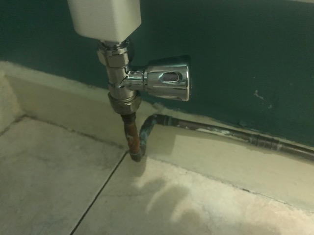

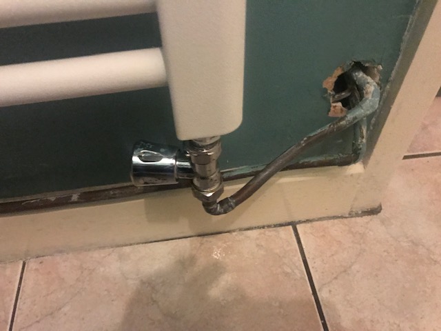

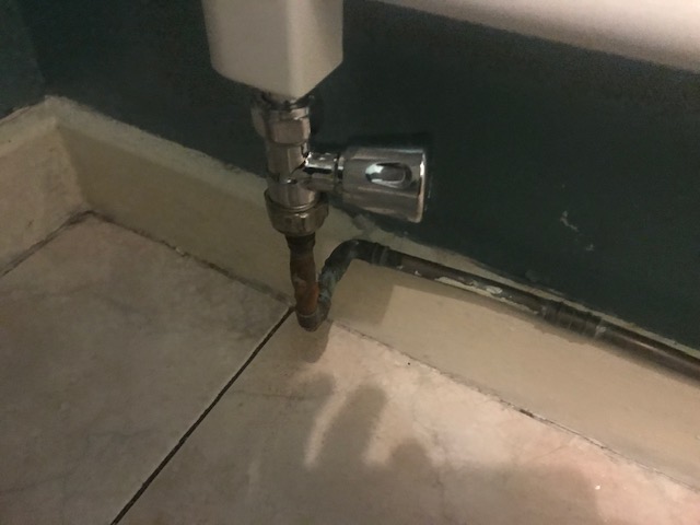

Ok i have added some pics for you
This is the valve with the problem
This is the flow valve the pressure from here is good
