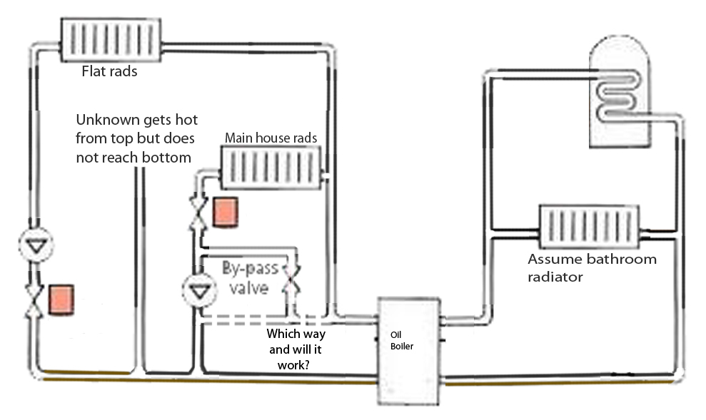

    Pipework not sure but think it is something like this Pipework.jpg the boiler and pumps are in a flat below the main house so would not hear them, only two wires between main house and flat so fitted Nest once motorised valves are fitted will be wired like this C_Plan_My_HouseC.jpg which is not perfect but good enough, I was first trained as a mechanic and then slowly moved to be an electrical engineer which included working for SLD pumps so yes aware of damage cavitation can cause, however as to if a real problem with central heating I don't know.
    If the Nest switches off at same time or before the TRV's then it should be OK, but how would I know, I can set Nest one degree lower than the thermostat in the hall which should mean that thermostat is always open, but how accurate are TRV heads? Far better if there is some relief valve which will allow water into the pump, maybe all it needs is a lock shield set so there is always a bleed of coolant, but this is all above my knowledge, hence the question, it may be I don't need any thing? But time to fit anything is before new inhibitor is added, plumber did not turn up today, so have a little more time before I need to know.

  13. mgw
    mgw New Member
    Question I suppose with pump on return, is where should that by-pass actually by-pass? Pipework-question.jpg
    The point I am making is the by-pass needs to prevent a depression rather than release pressure, so what setting and where? Flat radiators easy enough just open the kitchen TRV fully, no thermo syphon problem in flat, main house however a different story.
  14. Craig Watson
    Craig Watson Plumber GSR
    The bypass can go anywhere on the flow pipe and then tee into the return after the zone valve but before the pump. And as for setting, turn the valve to it highest resistance, then with your heating running slowly open the valve until you feel water lass through it, then give it a quater turn back, and that should be fine.
    You could also change one of the trvs to a lockshied so one radiators remains permanently open. But this will only work if your system doesn't have pump overrun.
