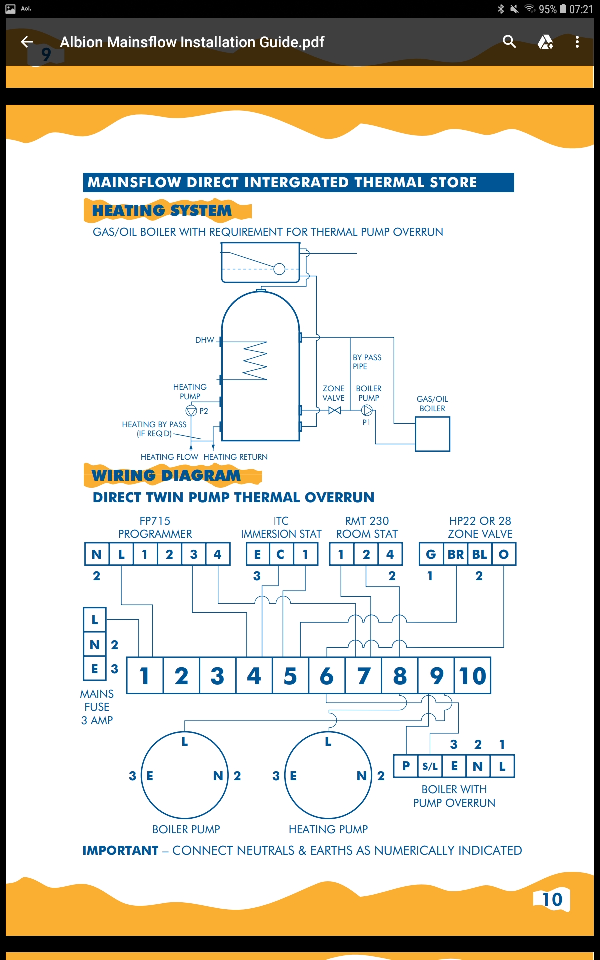

not sure how they could make this system work with only one pump. the hot water pump as you call it in effect supplies both hot water and heating when you demand both as it heats the store water then the heating pump takes the water out of the store to heat the radiators. With thermal stores you have to usually run the boiler on maximum as the store thermostat will be set to about 75c so if you run the boiler too low it will never turn off unless you use the timer to turn it off. One of the side effects of having the new boiler fitted is it is much more capable of maintaining this high temperature across the whole system resulting in much higher rad temps than you are used to. one way to check pump operation is to run hot water on its own and only the store pump should run. turn off the hot water if you have a timer and run heating on its own. heating pump should run but boiler shouldnt fire and store pump shouldnt run. looked at wiring diagrams and cant see any interlock between hw and ch operation that wont let you try this

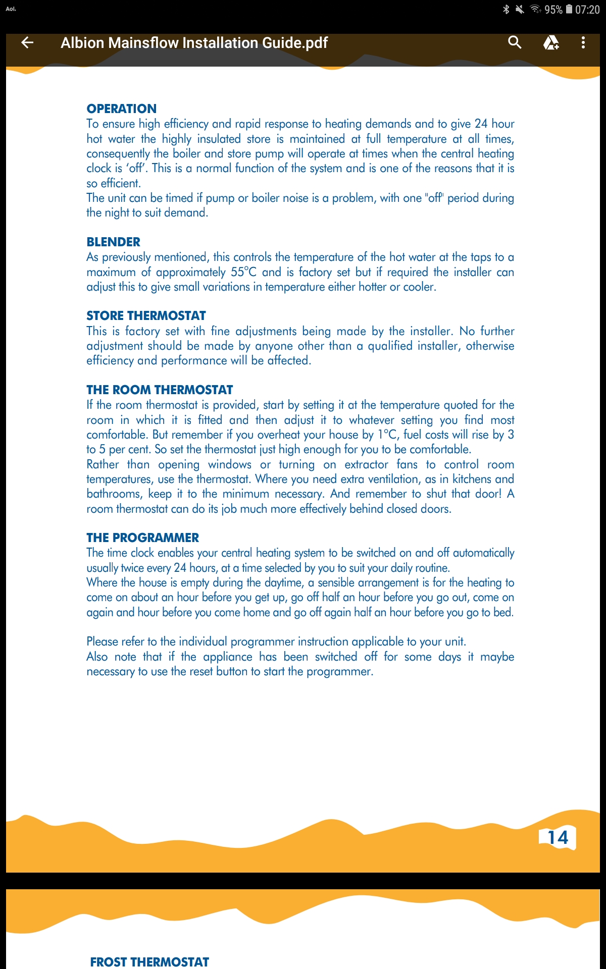

These are old pictures of the original store in the process of bring replaced like for like.
