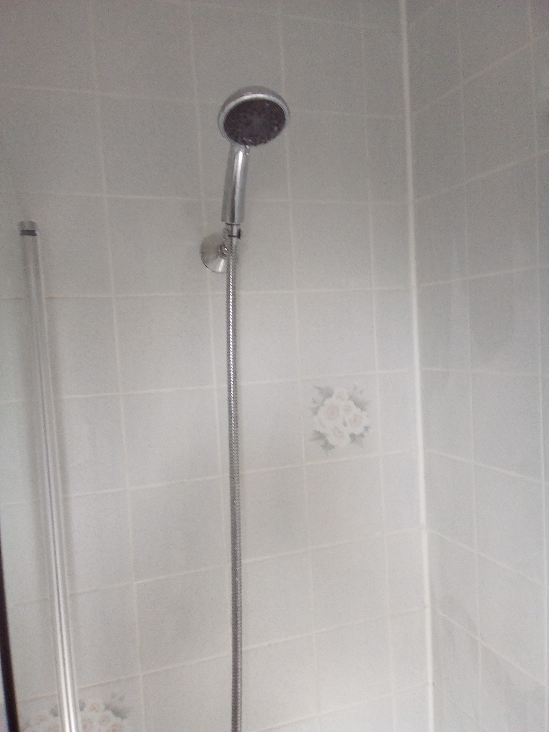

    See pics.
    They want more pressure to the shower head but want the cheapest option. Any suggestions?
    Water pressure to the bathroom is good it's just the shower head that's a bit tame.
    My suggestion would be to fit a new bar shower and a pump.
    What else could be done?

    What's feeding the taps?
    What isos are fitted?
    What HW water system do they have?
    What is the actual HW pressure (static & dynamic)?
    TBH that's a pretty poor tap from a flow perspective so my first port of call would be a better engineered tap with a better flow rate. None of those cheap types will flow well.

    From the picture, so I may not be seing the full story, that looks like a standard bath with a smooth bottom. Serious risk of injury to a standing user from slipping over.
