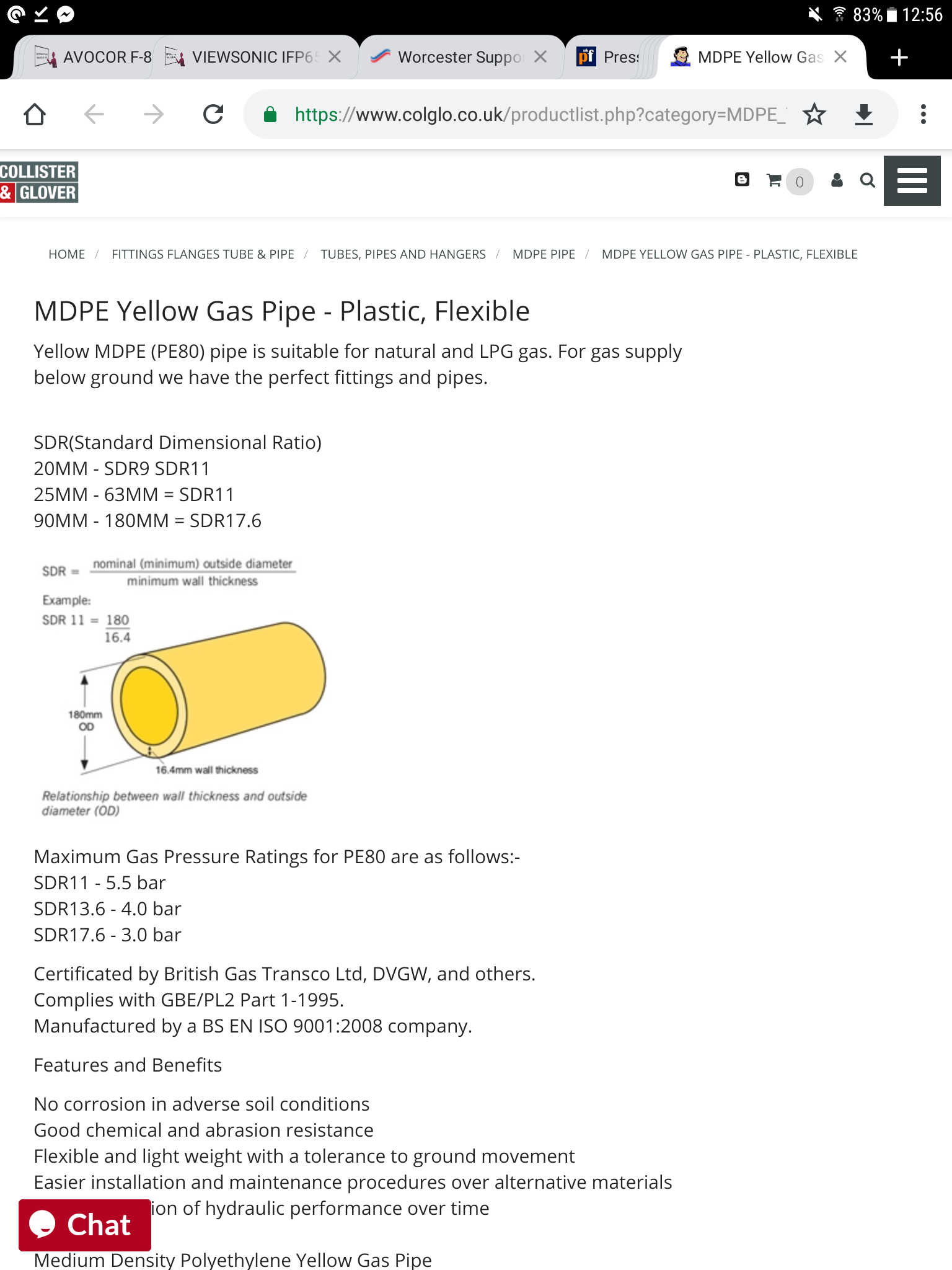

I have found this info on the pipe but no pressure testing method. This is a new carcass with no joins and nothing attached to either end.
Max pressure so keep under them and you will be fine
Test at like a bar
This is the max gas pressure going into the pipe though isn't it? So I would have thought I would need to test it to more than the 5.5 bar.
No that's the max pressure the pipe is rated to if you go above it could blow the pipe / split
