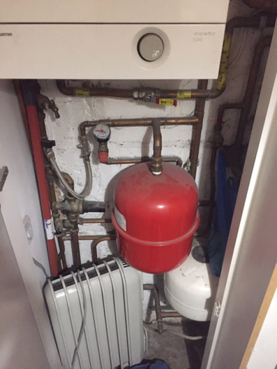

    Thanks for your comments. The original plumbing company sent someone back today, but they sent a different plumber. I'm told the part changed back in December was called a 'Pressure Reducing Valve' (see image attached). I explained to today's plumber that I was charged £500, and he pulled a face ie) wide eyes, look of shock! I laughed, and told him I also pulled the same face when I was charged £500. He then looked a bit awkward, and tried to suggest the first plumber changed another part as well (although he couldn't tell me what), but that's not what I remember being told back in December. In December, surprised at the cost, I requested a breakdown of costs, and a receipt, but nothing was emailed to me. Today I again asked for the breakdown, but I'm now being told by the office manager that the company has just 'changed owners' and they have no invoices. All a bit mysterious. The office manager says the 'fan' was also changed in December. Maybe shes right, but this wasn't explained to me at the time, and its odd that no paperwork is available.

    oh dear, that prv looks like a honeywell do4 ...the best prv
    on the European domestic market , it costs well less than £50.00, micky mouse ones cost
    less than £10.00. I cannot remember the spec but I am not sure it should be vertically installed...but others will correct me.
