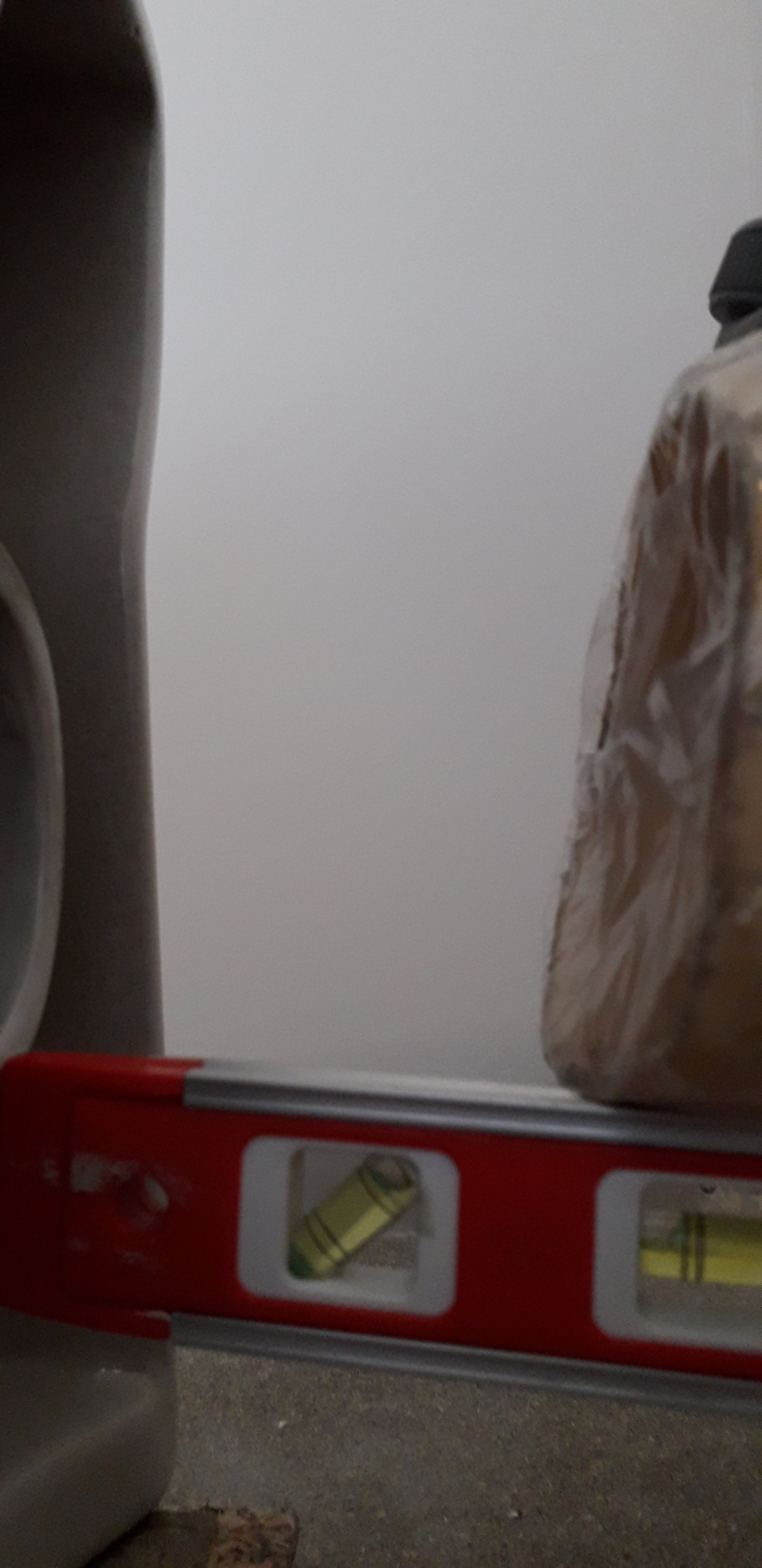

  13. NiccoloC
    NiccoloC New Member
    Going to try plinth 1st.
    Measured and 22mm plinth is sufficient to raise toilet outlet above connection to stack.
    If this does not work it can be undone without affecting anything else.
    Thanks for all the advice.
