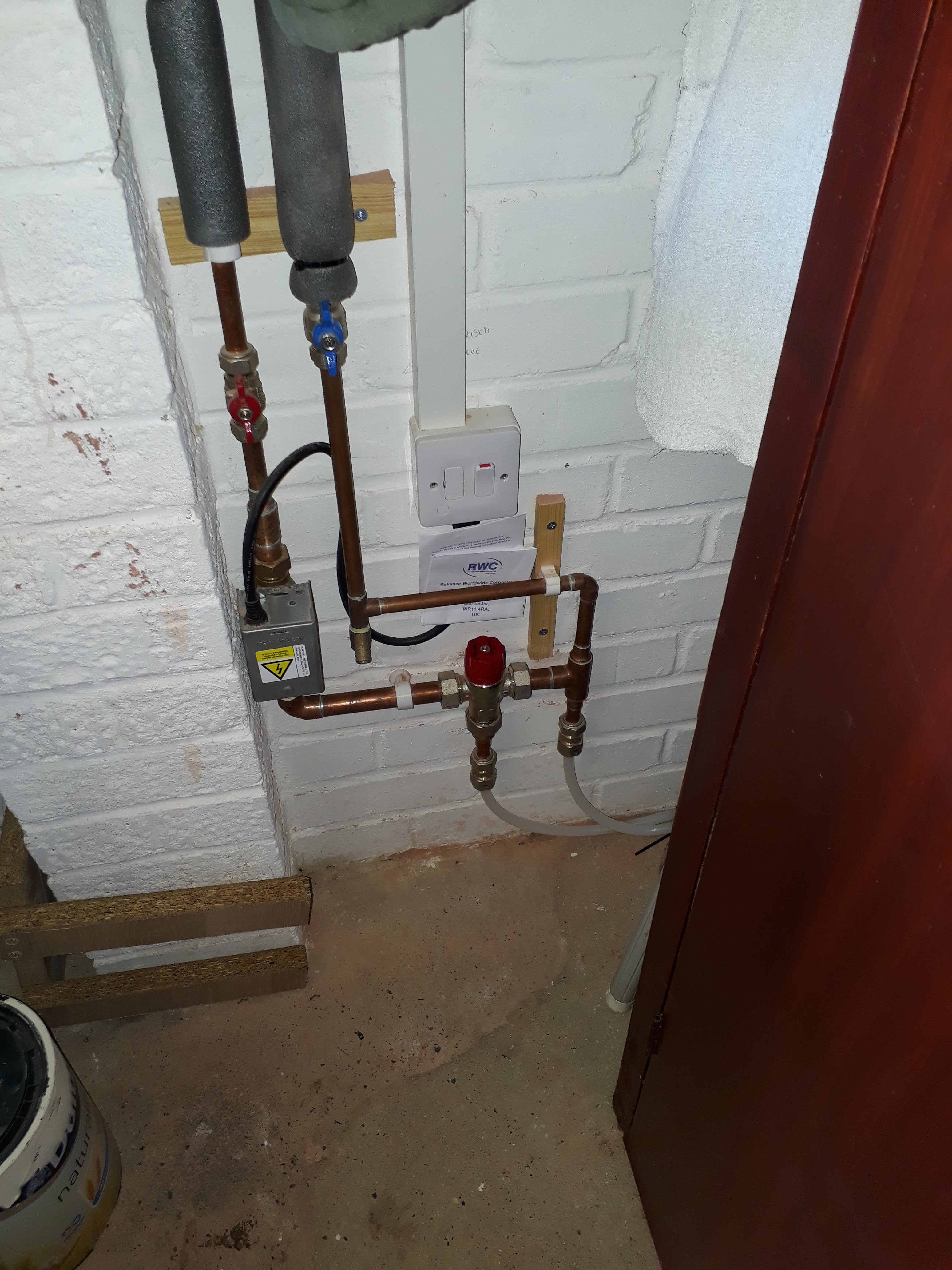

Mate inherited this had a look this morning for him any obvious faults? ,should work far as I can tell heatmiser programmable stat fitted in the hall way . Kop

No pump?

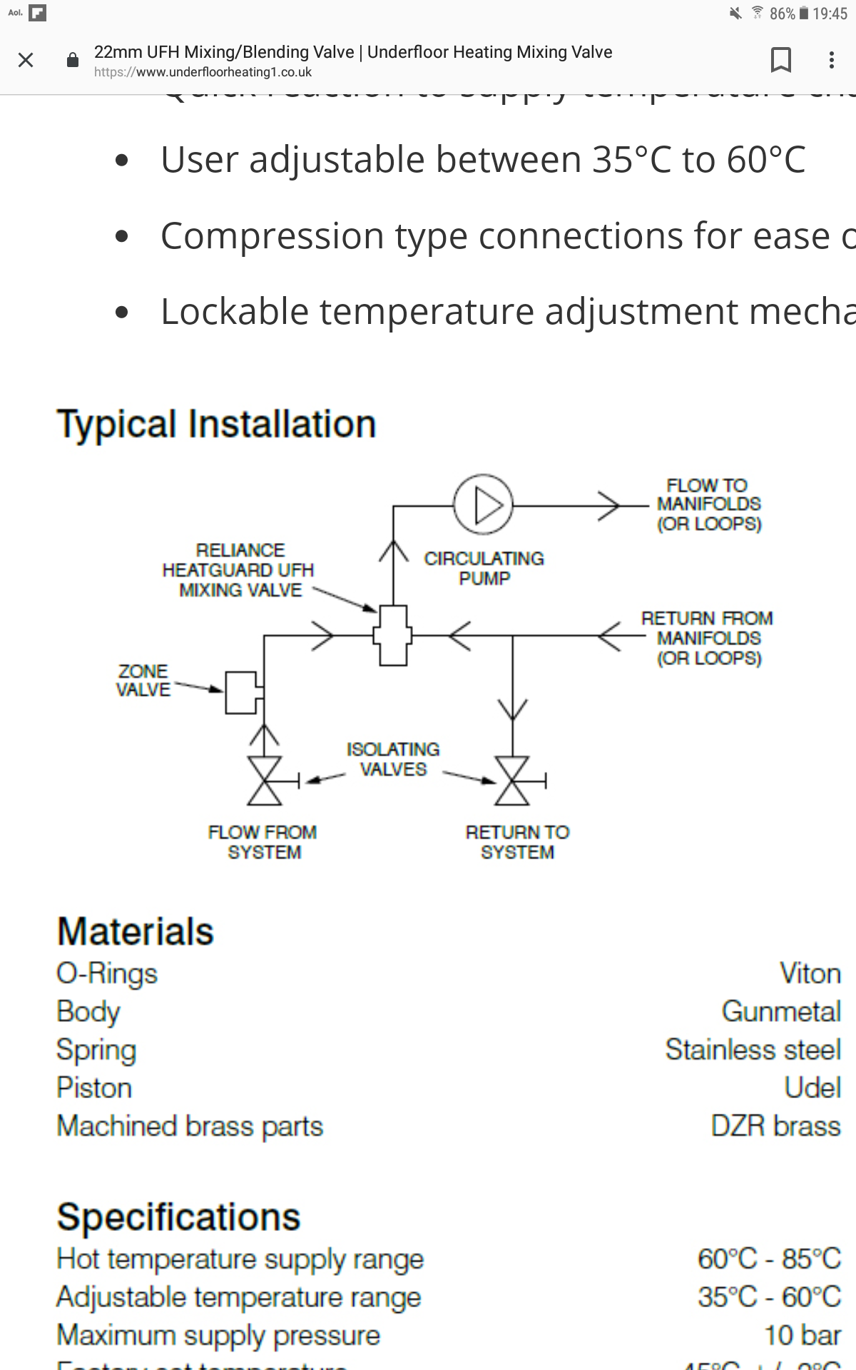

How does it circulate?
