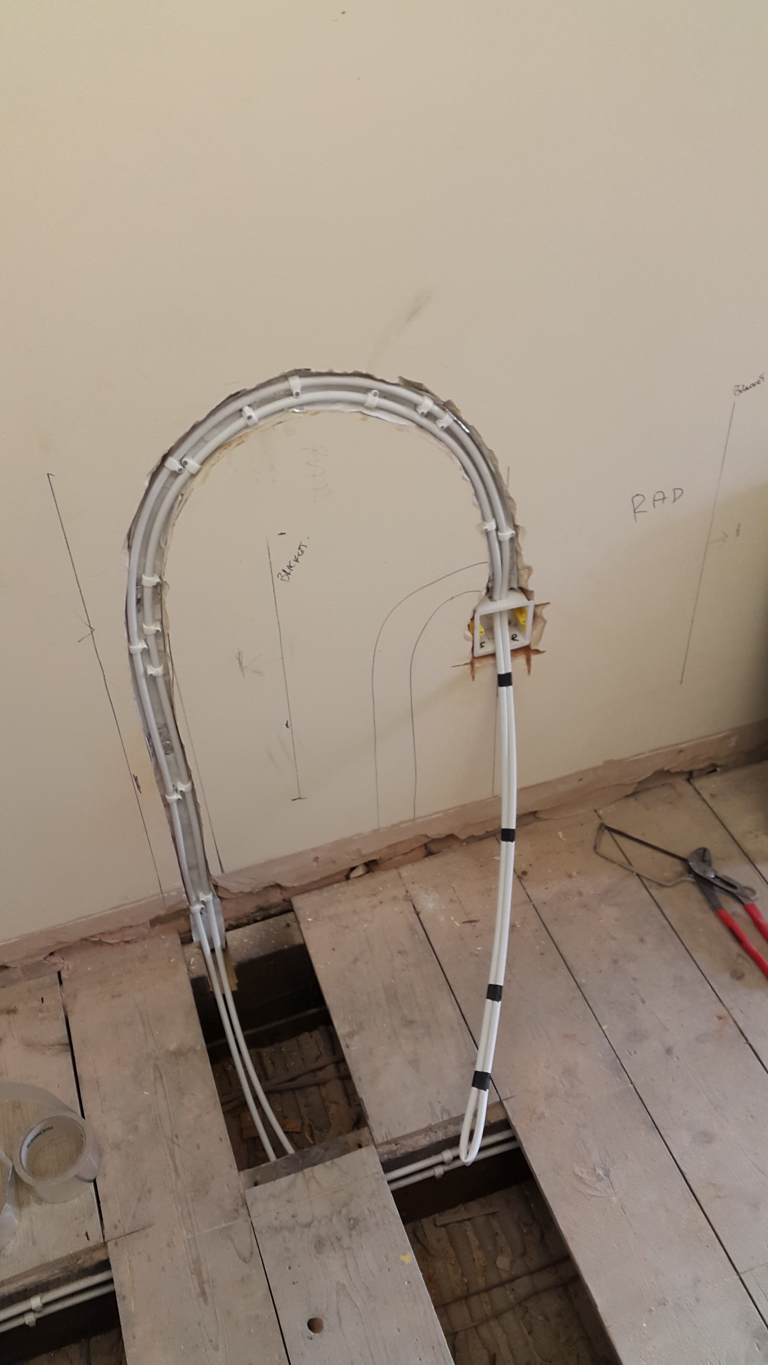

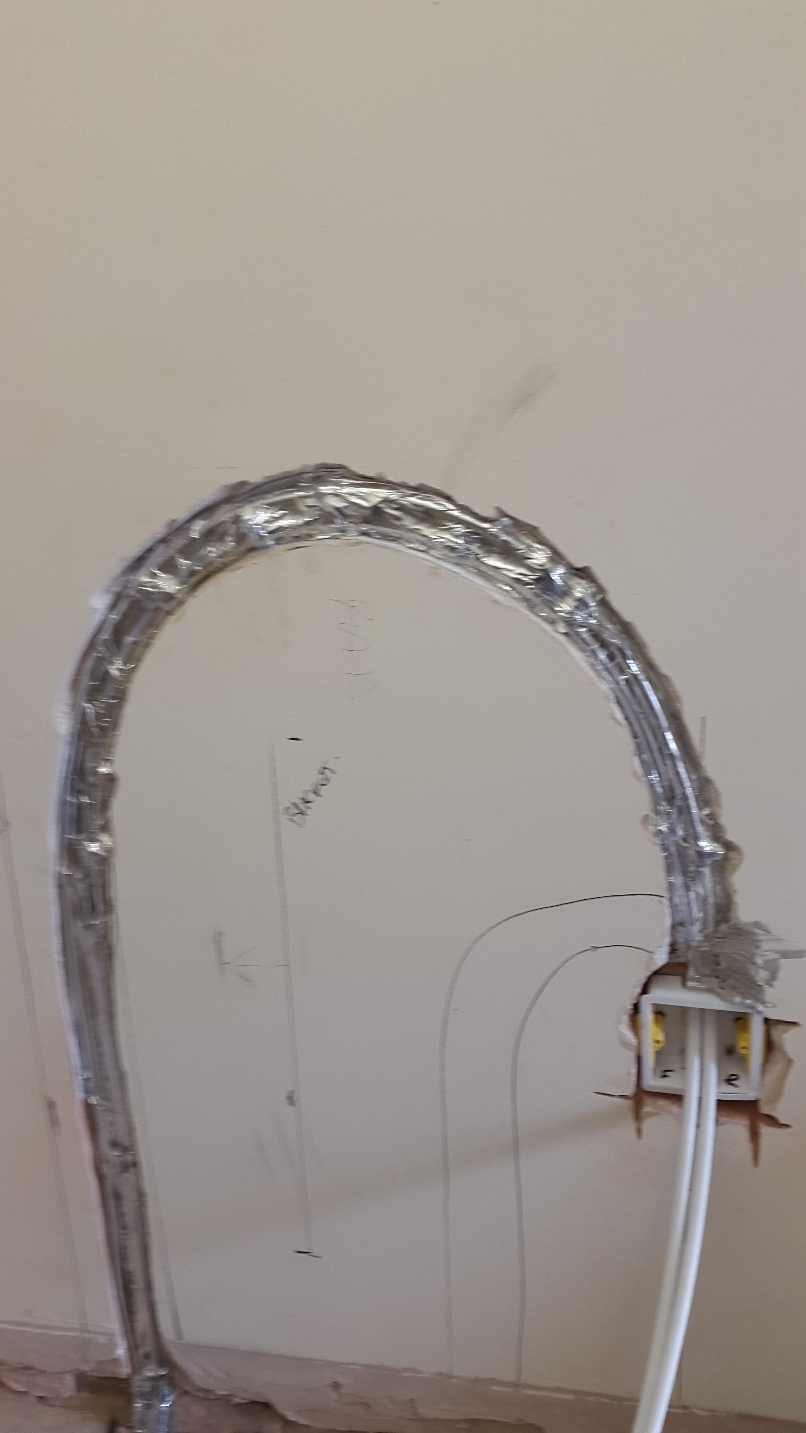

    Can you use 10mm plastic pipes into a junction box directly behind the rads?
    Just seen someone suggest this. Then there would be no joints in the wall?

    Yes you can but make sure everything is sized/designed properly. Microbore can be problematic

    If it’s dot and dab do you need to chase the wall?
    Put a pattress behind rads

    That looks great, thanks very much. And then just go plastic all the way into the rad valves?
    I wanted to conceal as much pipe work as possible and not have any plastic on show..
    Yea i get what you mean on 10mm.. i would rather use 15..
    Can you get these for 15mm pipe?
    Sorry if i sound like a complete moron. Im not the whole time i swear. I just had to look up what a pattress was..
    So if the pipes terminate in a patress behind the rads, the dot and dab board just goes to the depth of the patress?
  13. ShaunCorbs
    No they don’t do them in 15mm
