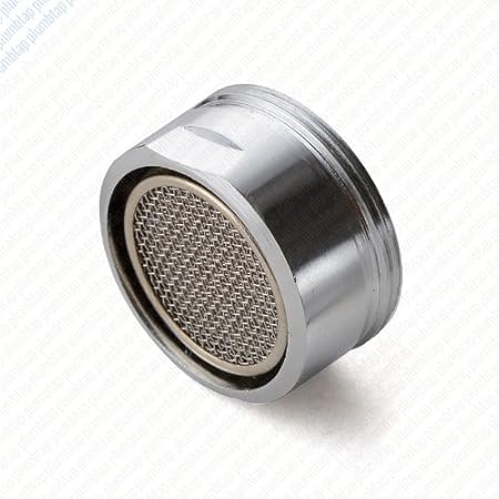

    I also wander whether it could be that they're being trapped by the aerator and only being released in small amounts of a long period of time. If it has one of these (pic below) I'd take it off, let the tap run at full rate for half an our or so and give the aerator a good rinse.

    Regarding whether the tap has an aerator, I'm not sure, but when the plumber returned he removed what he called the filter from the end of the tap which contained a large shard of metal, and rinsed it through. the tap is a Bristan Manhattan (non easyfit version):

    Remove the filter from the tap which either unscrews or is pushed in and have a look then run the tap for 10-15 minutes and then replace the filter.

    As rpm say, take it back off, leave the tap running for decent amount of time and I would also give the filter a good rinse. If you do so in a bowl you should be able to keep checking you've got everything out. I think particles have got trapped in the mesh and are being released bit by bit and its going to be impossible to see them by eye if they are.
