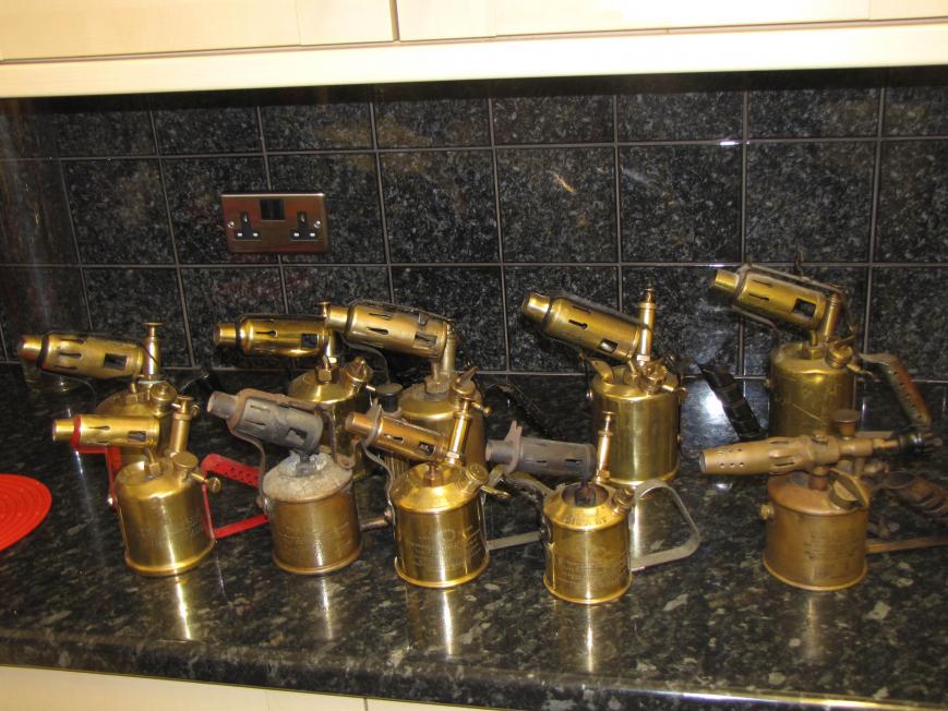

Take your pick
And i have more.
Now that is what I call proper kit !
Will last not like all the tat we buy today ?
I am ashamed of you tamz, at least 2 of them need polishing :)

Wow! Ive seen drawings but never seen one before?
Could i buy one!
I like steampunk styled stuff and would love abit of plumbing antiquity!
I've got fond memories of my fathers paraffin torch flaring every now and again when you first lit it. It was a real advance when he got his Bullfinch torch and used a 3.7 cylinder of propane. Bit of a pain lugging it round roof spaces though.
