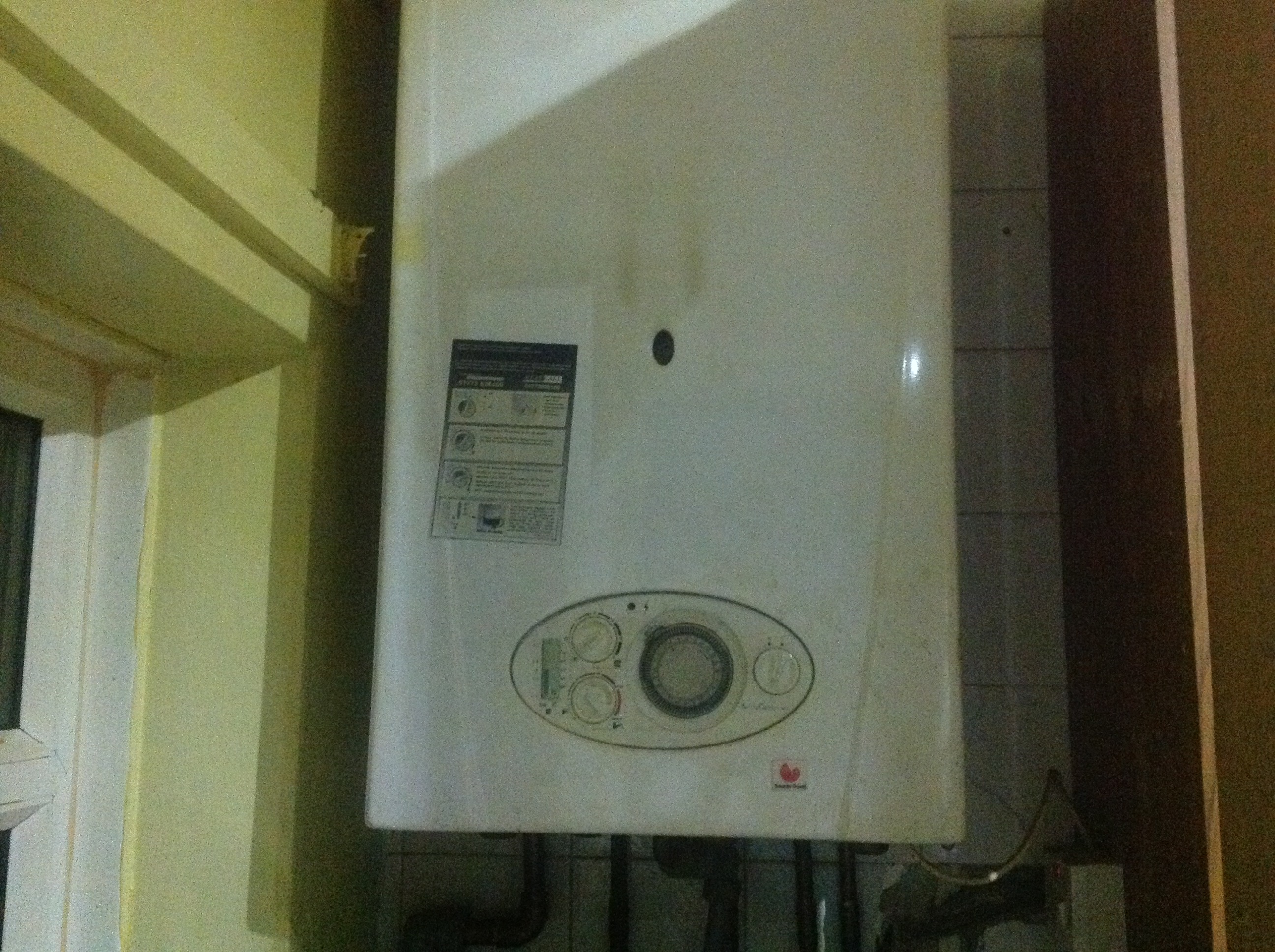

Hi there, looking for a bit of advice. Need a new boiler (combi) Havnt got the money to pay for one up front. So we're talking financed monthly payment.
Anyhow my twenty yr old daughter searched online and arranged for someone to come and give us a quote . I was at work when they came. He's had a look and said we need to replace some of our plastic piping with copper and included that with the price. He's since messaged her and said his boss has informed him that all the plastic piping must be replaced with copper. All I'm asking is does this sound legit? I'm quite happy to pay if it sounds right, just been on some forums and some say plastic some say copper and as a complete novice I'd like to ask folk who have a better idea than myself.

My boiler is Defo very poorly. I have no issue with getting a new one , I have a choice of hot water or heating I obv went for water as I can plug things in to heat.
