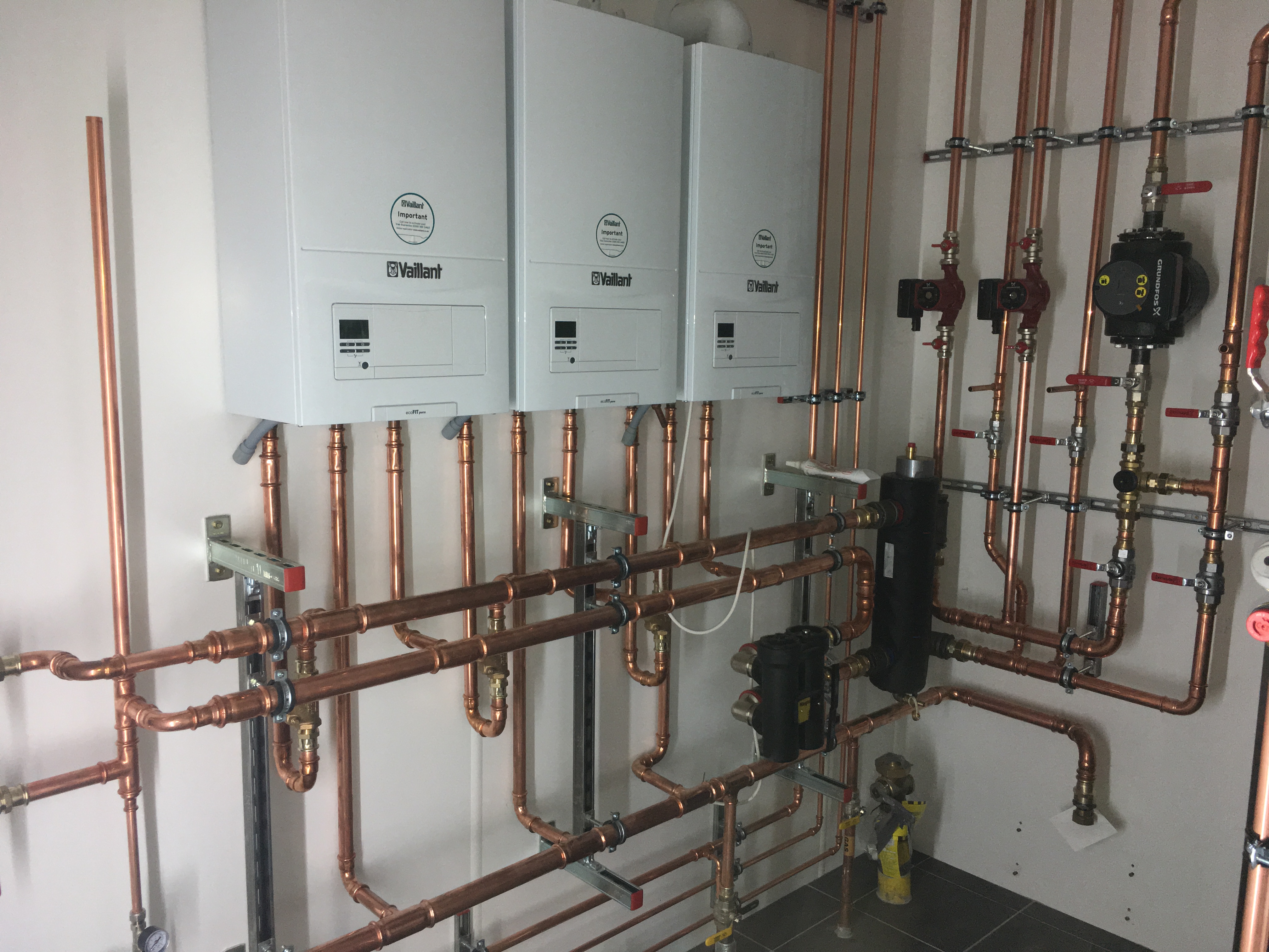

One positive from today - Yorkshire Xpress fittings are brilliant aren't they, made in seconds! I'm a convert.
Is it normal for the end of the pipe by the fitting to bend onwards very slightly? Nothing leaked but I'm guessing it will do as it's basically a big pneumatic press
