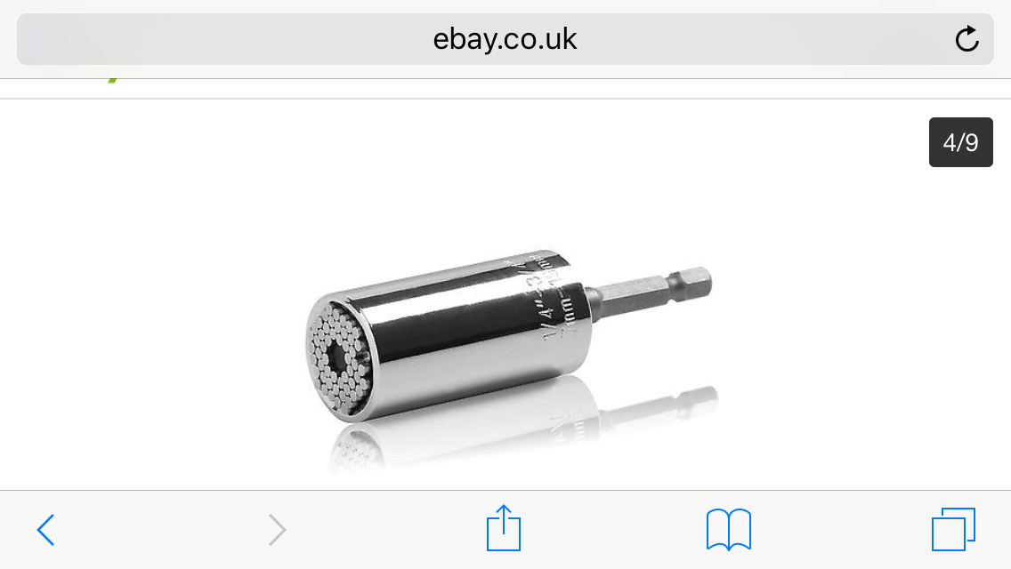

I keep a gator grip in the tool box. You can buy one on the auction sites for less than a 5'er. Fits loads of stuff.
