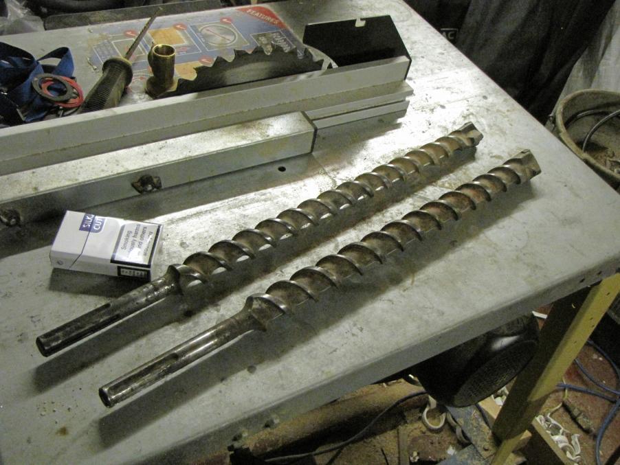

[DLMURL]https://www.speedyservices.com/c0202336-s-makita-standard-sds-max-drill-bit-40mm-x-570mm[/DLMURL]
That picture doesn't do it justice, I will take a pic the morn in daylight so you get an idea.
Blimey that drill is a beast. Do you actually use it that much over a normal sds?
I use it for bigger holes and on hard stuff. There is a lot of granite where I live. My normal sds I use upto about 20mm in block.
It can also be used as a chisel for demolition etc. Expensive but its not failed me yet!
