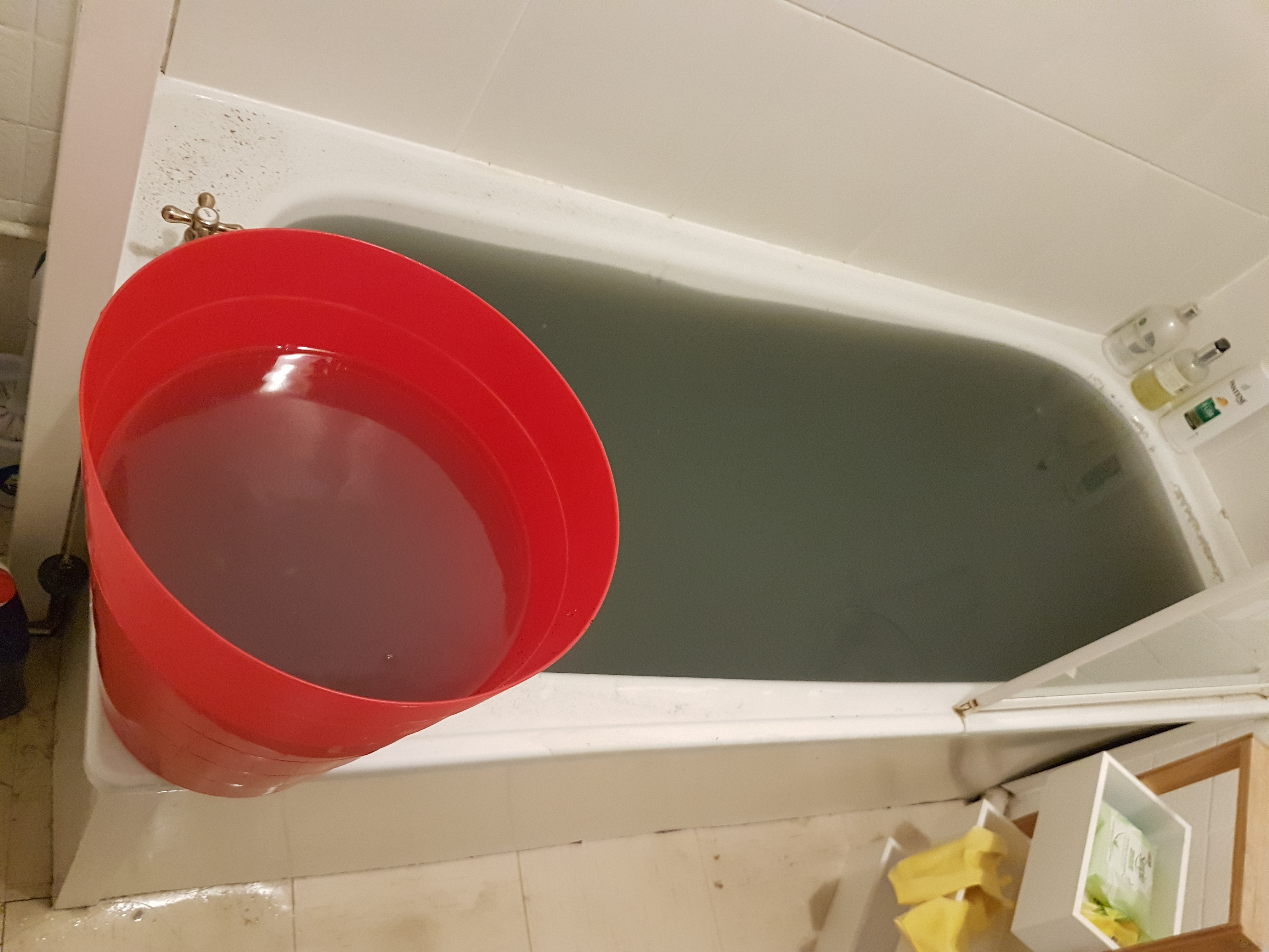

1. (Unless it's coming from your own flat, e.g.. into the kitchen sink when you use the washing machine ) The partial blockage is in the shared pipe between you and the flat below hence when water is used above it does out in yours. Get the landlord on it asap before it becomes fully blocked and backs up catastrophically when they run a bath upstairs. See attached.

That is some blockage

A picture paints a thousand words.
Meanwhile downstairs (re)paints their ceiling.....
Thanks, yes we did get the landlord round to clear it and it worked for a while but began gurgling again. I just wondered if there was some sort of one way valve that would prevent ever happening again.
A one way valve might stop it coming out of the main stack to you but once main is blocked / partial then water will push against the one way and seal it closed so your flat won't drain, then the main stack will fill, up to your neighbours bath and then it will overtop and come thorugh your ceiling. Sorry, get someone who can to clear the blockage, also get everyone to keep hair, coffee grounds and chipfat out of the pipes, I find these are the main causes. might want to get a cctv survey for burrs, poor joints on main.
