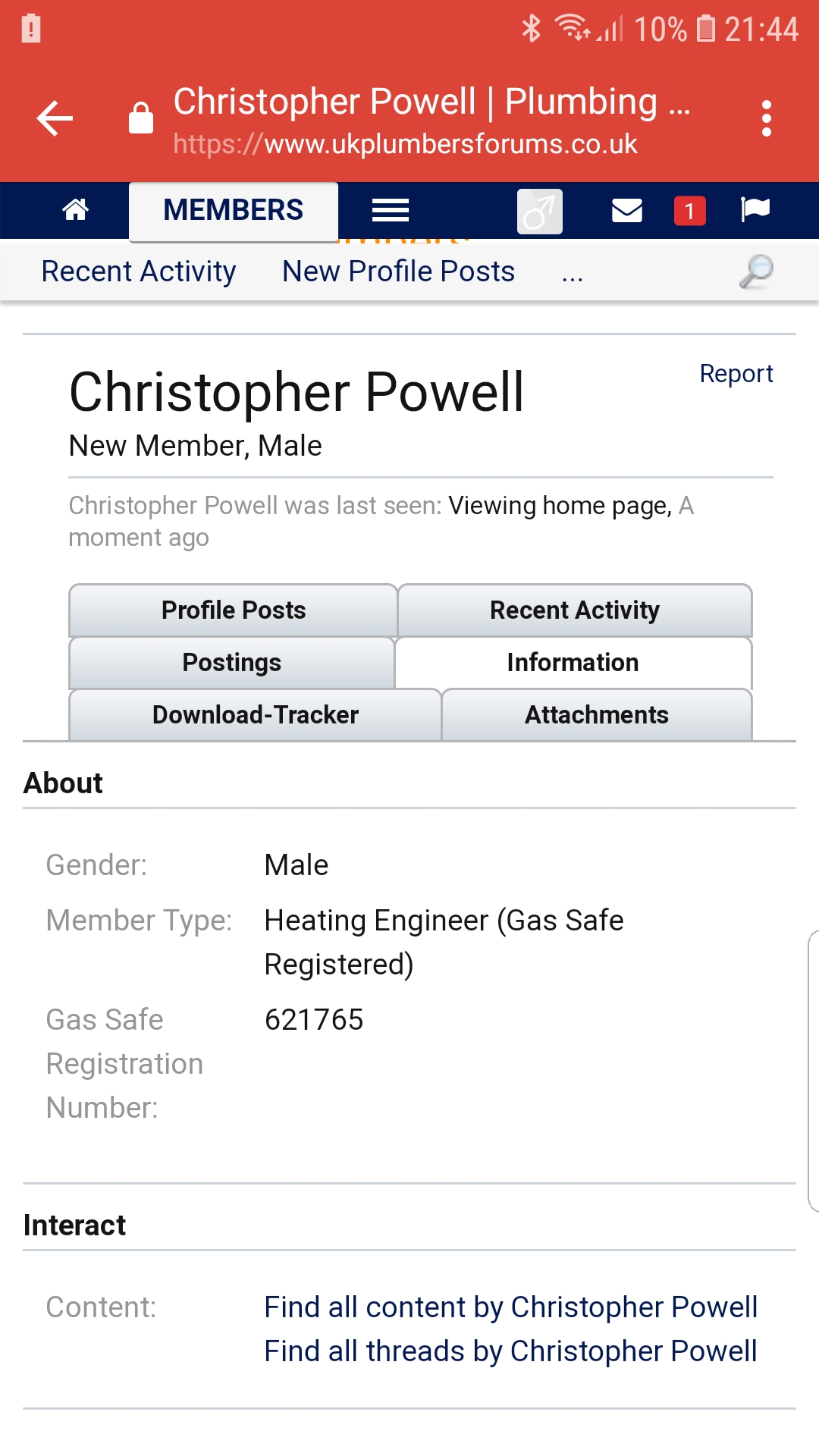

If you were registered, you’d have the blue badge.. but you don’t get the free parking
You rang :D

Will be moved once he has his badge don't worrie will mop up
Done
You have not broken any rules.
Glad you got the answer you need.
