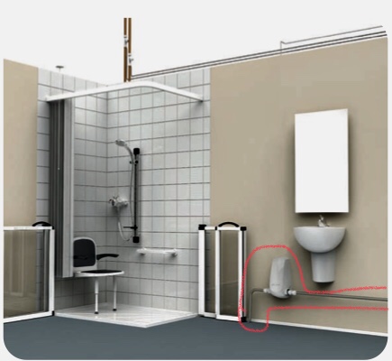

You have a thermostatic mixer shower (not electric), which looks like it’s pumped, hence the electrics and pump in the airing cupboard. If there was a pump on that waste you should have x2 flow switches to activate the pump, it looks shallow, so suggests to me a pump, but I could be wrong. Is there anything in the bathroom that resembles a pump, or can you see any rising pipework at the end of the tray?

Thanks again for your advice. There's definitely nothing on display like your photo so I will turn it on and hope for the bestHello again,
What I meant was the non shower end like in this attachment, usually the pipes are on show or concealed somewhere usually in a cupboard, but accessible. Like you said try what Shaun and Craig have suggested. If it’s a pump though could be something as simple as it’s turned off on a fused spur.
How did you get on Batman, does the shower tray fill up if you leave the shower running?Thanks again for your advice. There's definitely nothing on display like your photo so I will turn it on and hope for the best
