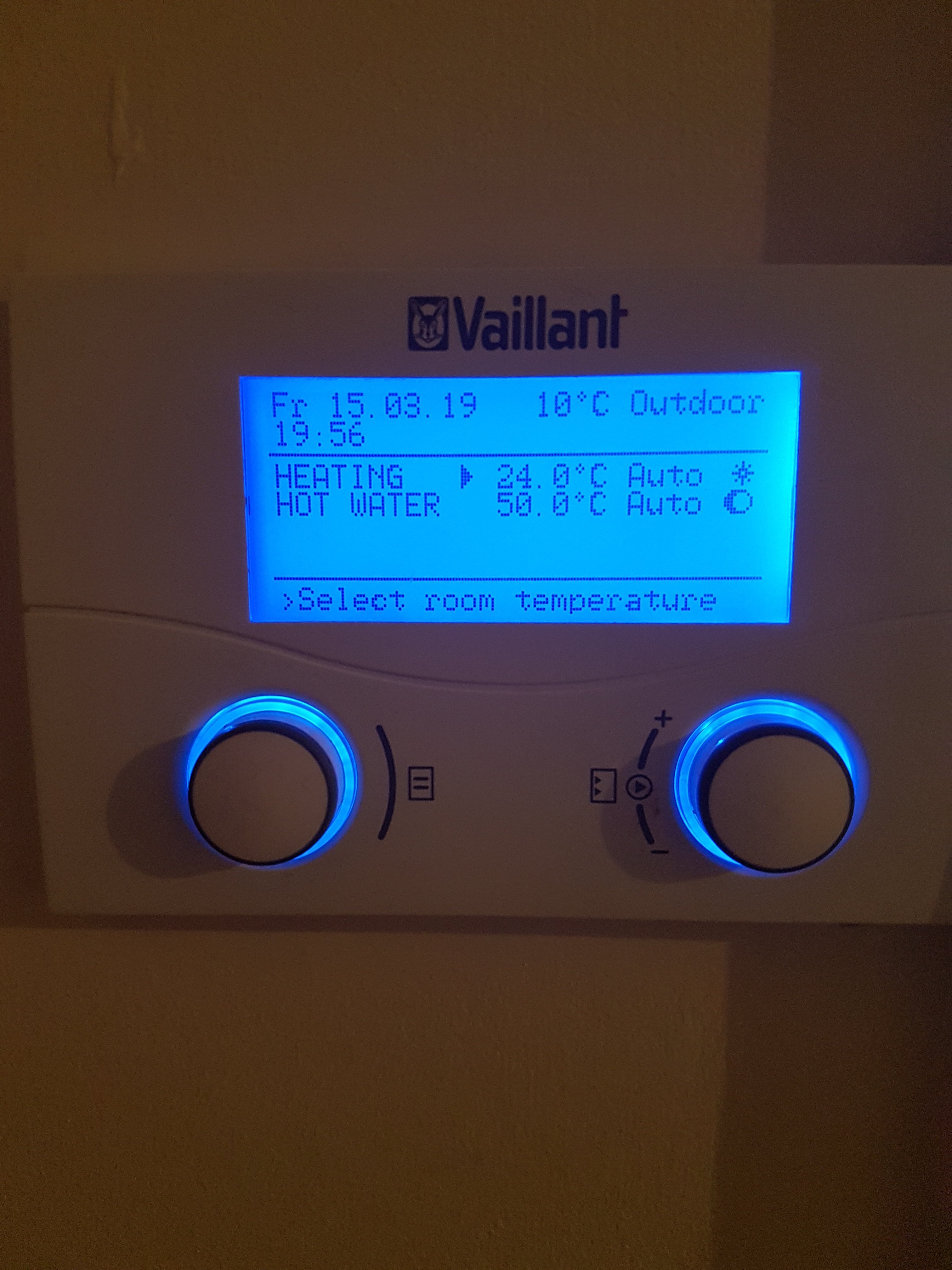

    I've got a combi valiant ecotec plus 837 with a control vrc 430 weather compensator controller fitted.
    The picture attached is the mains display of the vrc 430 with both heating and water set to auto.
    1) The only purpose I have used auto is for the heating to kick in when it's in for the heating timer. Is there any other purpose for it to be on auto?
    2) what is the purpose for the hot water to be set to auto if this is a combi boiler. Isn't the purpose of the combi boiler to have hot water on demand? There is currently no timer settings settled for the domestic hot water.
    3) what is the best temperature to have the hot water set on? As from the pic, it's set at 50 C but I've read online and a few sites recommended at 60 C.

    Not come across a VRC430 in a while and certainly haven't programmed one for ages! If it's anything like the Worcester ones, the timer settings for the HW I would imagine are for the 'Comfort' mode. So you can have comfort turned on during set periods so you get HW quicker, but can have it off during the night to save gas and prevent the boiler coming on.
    HW temp can be whatever you want, doesn't matter as it's a combi. I usually recommend 55oc. If you had stored HW like an Unvented cylinder then different matter.

    Google it and download instructions if you don’t have them. It can be used to control domestic hot water (dhw) from an additional source. I’m not sure it relates to comfort mode.
    Stored dhw - 60 degrees
    Combi - user preference, but I usually set between 60 and 65.
