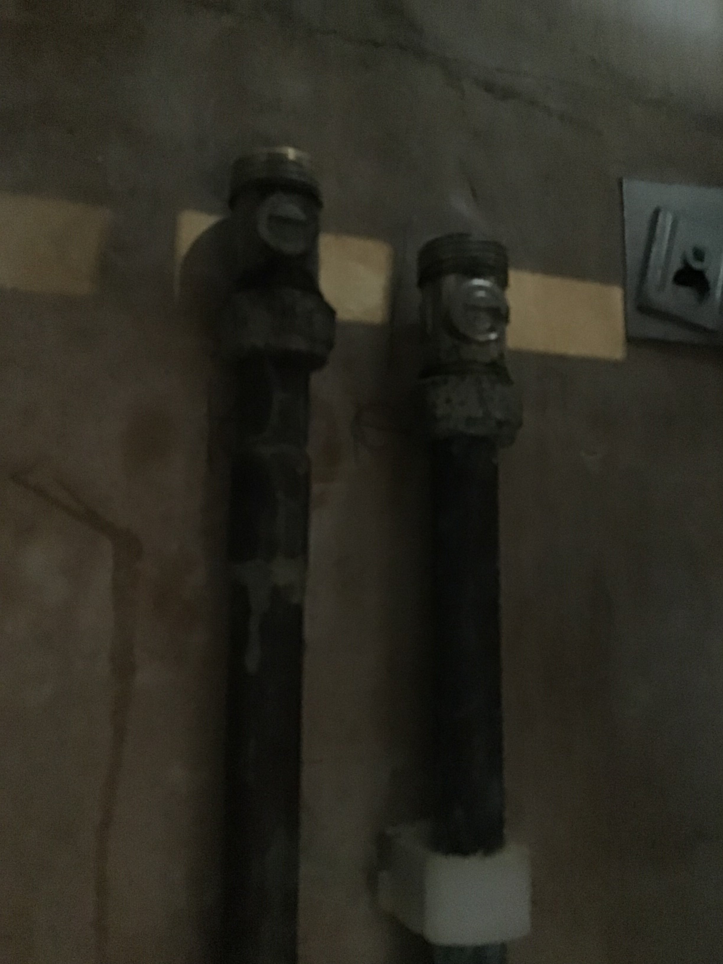

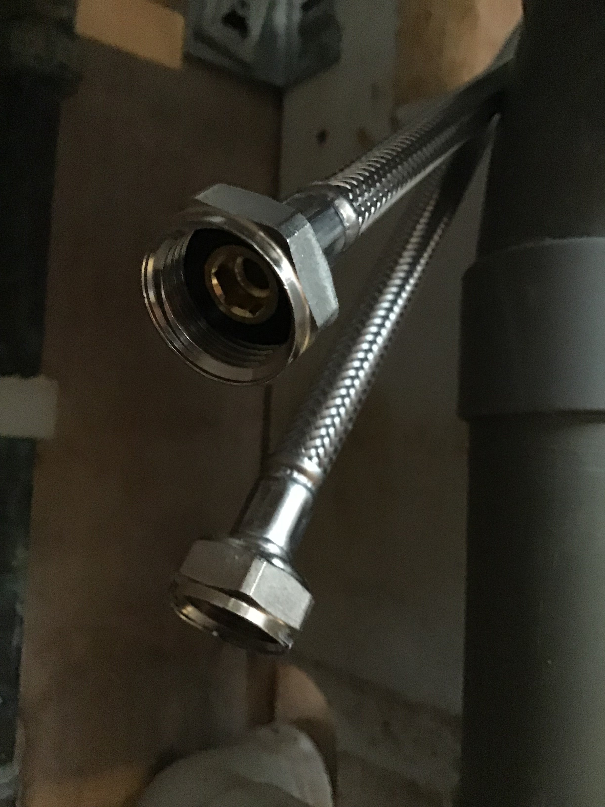

I’m trying to fit a new Grohe tap. Flexi hoses are 15mm and don’t fit the 21mm (guessing it could be 22mm?) existing thread on the water feed valves. See pictures attached.
Is there an adapter I can buy?
Or do I need to replace the valve for a 15mm one? The copper pipework itself for the feeds is 15mm.

3/8th thread
1/2 normally measures around 20mm if smaller then its 3/8th

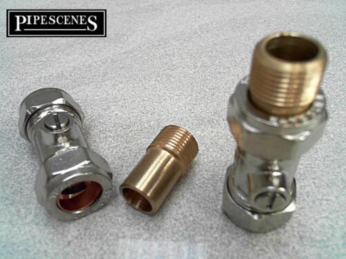

https://www.screwfix.com/p/brass-compression-adapting-flexible-tap-connectors-15mm-x-2-pack/2665r
https://www.screwfix.com/p/brass-co...exible-tap-connectors-15mm-x-3-8-2-pack/6089r
you still got the top nuts for the iso valves if not your going to need some and a replacement olive

easy way do the flex nuts fit onto the valves in the pic if not its 3/8th
as for the valve / fitting
adapter
nut
olive
valve
thats how it should go together

Ben,
You have your measurements mixed up. The chrome plated water feed valves are 15mm with 1/2” thread. Your flexi hoses are what @ShaunCorbs said are 3/8”, although they do look like 3/4” which is why @Riley said bath tap - which are usually 3/4” thread to connect to. You also haven’t said which tap you are installing (not that it really matters).

Every Grohe basin tap I've fitted has been 3/8".

Anyway, as promised here’s the update:
The adapter @ShaunCorbs recommended was exactly what I needed.
Fitted it all, even got the hot/cold feeds for the flexi hoses right (pure fluke), which is a miracle since whoever put the water feeds in decided they wanted to mix things up a little and put the hot on the right.
Turned the isolation valve back on and after a few second realised that one of them was leaking from the screw... tried in vain to fiddle with it but gave up and have since read that this isn’t uncommon in old isolation valves that don’t get used much.
Anyway, ended up chopping the pipe just below the old valve as I’ve got rather long flexi hoses from the tap. Was getting late so put one of those stop plugs on the pipe end and left the valve fitting for tomorrow. Enough time under the sink for one evening...
