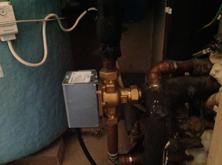

Actually, they have just told me they will not do anything outside the boiler, so the diverter valve (which I believeis outside the boiler) won't be covered ....is this the diverter valve? IMG_2816.jpg
Get someone to come and take a look
I'M going to go out on a limb here and say that the system MIGHT be heavily sludge up, blocking the heat ex (causing the banging) and that sludge or just age has caused the diverters/3 port valve to stick in a position where you get hot water and Central heating,
I'D get a local reputable engineer out who is gas safe to take a look and look at the condition of the water in the system

Ask them to check the expansion tank pressure and walk around and check for leaks on the radiators.
Get them to check PRV and operation of the motorised valves.
