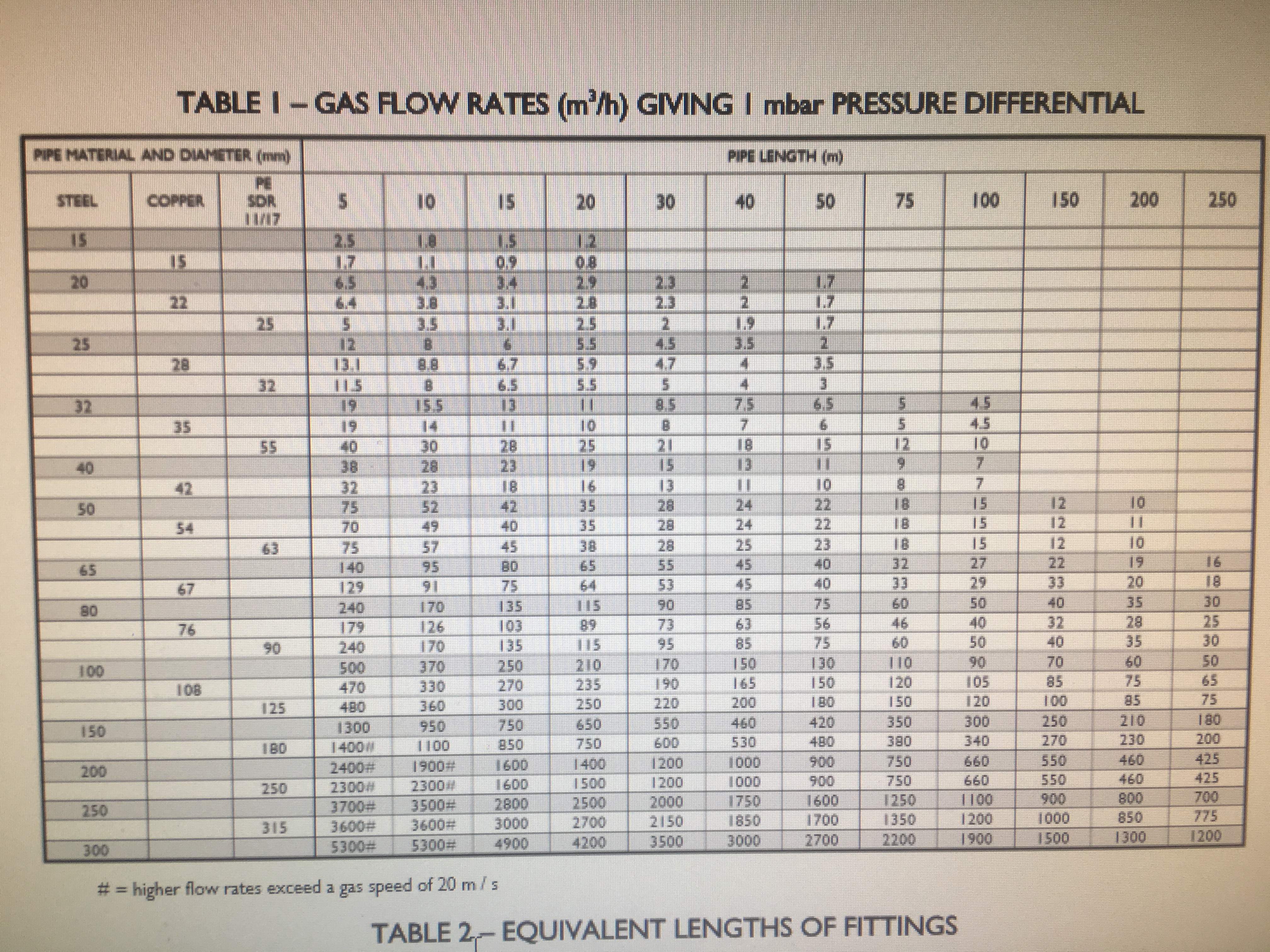

    Guys , do any of you fine chaps have the figures for 35 mm
    copper tube flow rates ( 3 , 6 , 9 meters etc etc ) only one I have goes up to 28 mm .

    Any use ?

  3. townfanjon
    Hero status lol , cheers.
    Its odd that goes up in 5 m increments instead of the usual 3 m
  4. ShaunCorbs
    Commercial list mate hence it goes upto 12” :D

    Cheers if you have it , no worries if not I have copied Shaun's, it seems domestic stop at 28 mm , I think lol
  9. Harvest Fields
    Probably because we can only run about 4 meters of it before it becomes classed as a commercial install:D:D. But I’m not bitter about that at all:D:D

    Lol , It looked like I would need a couple of meters of 35 on this quote but it can all be 28 so dont need it now but its handy for the future .
