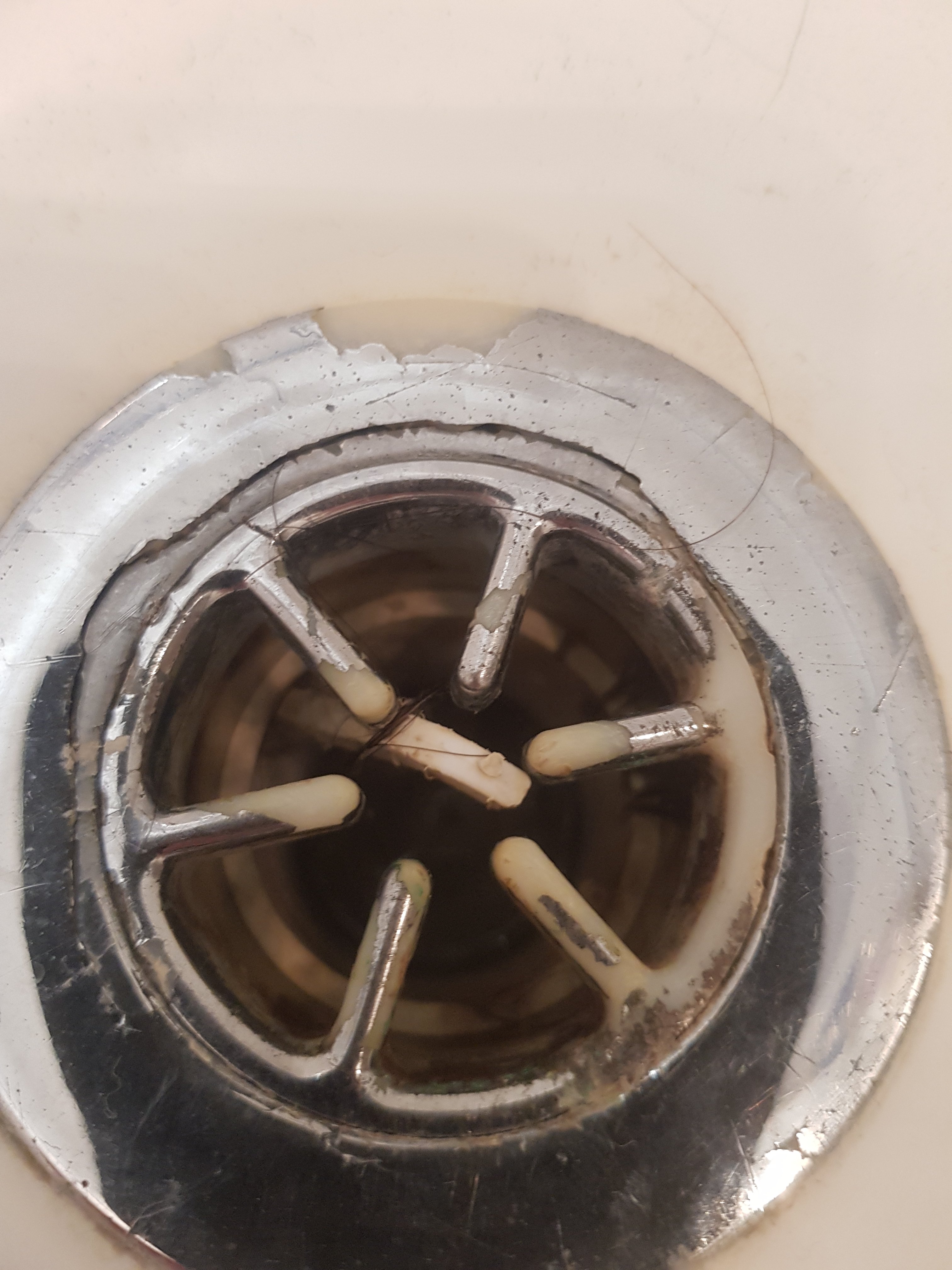

Hi I have just bought a house and have just noticed a crack in the shower trap ,top part that connects to the tray.
There is no access to underneath of the shower tray.
Anyone identify the trap ? And can I replace the top part without having to remove the tray .
With access below the tray it's fairly easy to replace. Just looks like a standard mcalpine shower tap
https://www.NoLinkingToThis/p/mcalpine-shower-trap-white-40mm/5075v
If you have no access then as above, a small hole in the ceiling below, can easily be filled sanded and repainted so you won't notice, or remove the floor next to the tray so you can reach your arm under to hold the trap.
However, if your feeling brave, you could unscrew the top part and if the waste is supported or sealed to the underside of the tray then you could replace the top part with minimal fuss. Just be warned that it doesn't always work and if your not prepared to remove the ceiling if it goes wrong, don't try it.
Have done that a fair few times with success, takes a lot of patience and no silicone to hold it underneath, just a lot of feffin and jeffin. :)
HI
I have the same problem, top crack on shower trap and large stone slab and no access underneath. Did you remove the trap from above or try to seal the crack?
Thank
