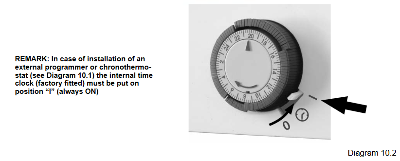

Advice, I'm wondering about the glow worm combi that has the mechanical time clock displayed on the front panel, can this be disconnected? As I'll be installing it in the loft and using the exciting room stat/ programmer.
Not much experience in glow worms and I don't do electrics.
