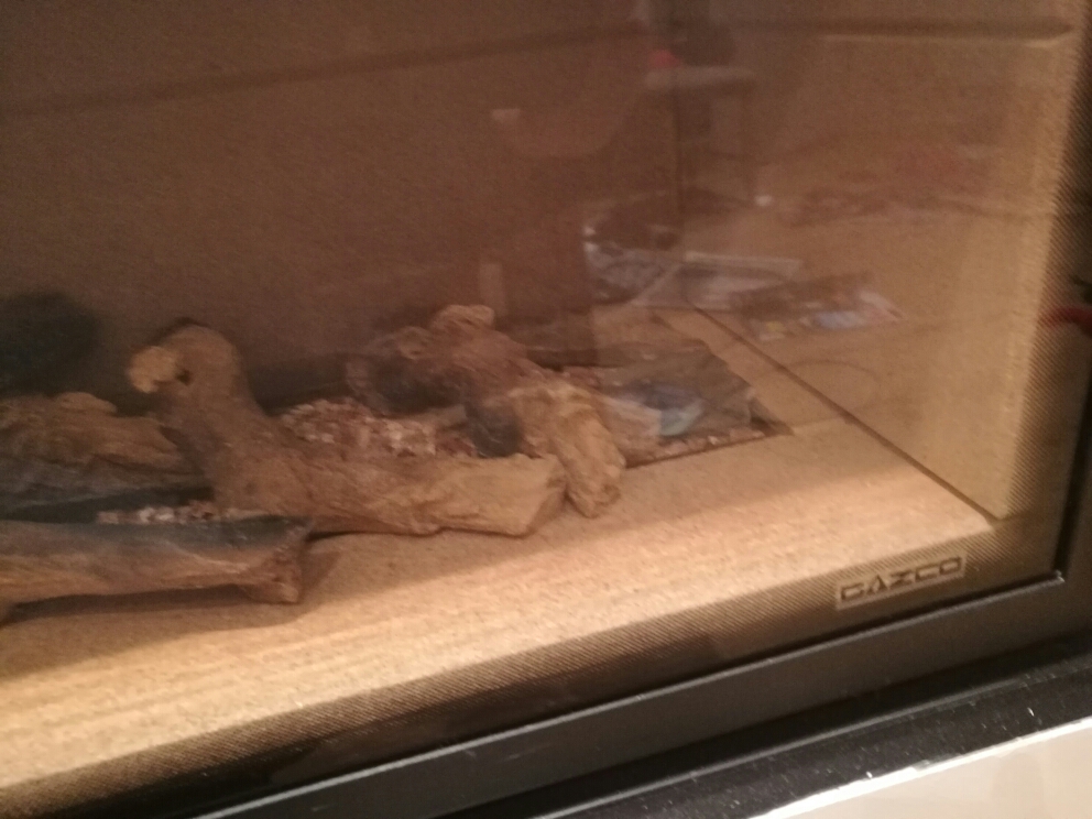

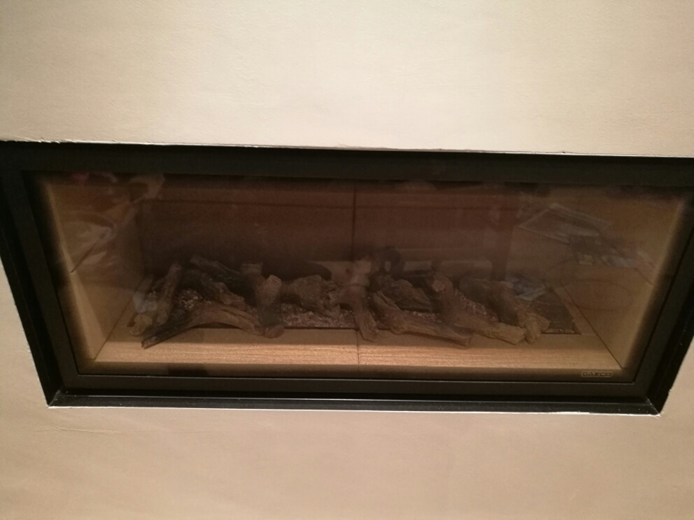

I have inherited what looks similar to the current Gazco Eclipse gas fire but the sellers left no instructions. I have had 3 gas engineers in the house but none are familiar with the model and specifically how it is opened/accessed to begin with. One did say it looks like an allen key fitting.
I've attached two photos - its recessed/hole in the wall type with a metal brown frame. The frame is not demountable or flush, with a 1" gap around. The top of the fireplace inside the recess appears to have to threaded bolts.

Looks like a Gazco Studio 1 maybe a slimline mate. Call Gazco and ask them to email you a set of user instructions. 01392 474000
Also once you have the instructions. Get a Gas Safe Engineer out to do a service as I’m sure there was a safety alert issued about the draught diverter on certain models. Also give him the part number for the oxypilot so that he can have one on the van. As you/he doesn’t know when it was last changed.
Cheers.....looks like the model I have, found instructions online for that and it mentions using a hexagon key on the top side which looks right. Cant see how the front frame lifts off as mentioned but likely hasn't been moved for years - making progress.
Cheers...looks like the model I have, found instructions online for that and it mentions using a hexagon key on the top side which looks right. Cant see how the front frame lifts off as mentioned but likely hasn't been moved for years - making progress.
You are welcome. The important bit now is to please get it serviced. By a GSE. The safety alert is for a critical Flue part and needs to be checked before use.
I'll get back on it, I gave up last year and forgot about it over the warmer months, a challenge finding someone familiar with it, thanks again.
I know a couple including myself. Give me a shout if you get stuck. I’m only north Brum. But I know someone in knowle. Maybe closer to you.
I have found a GSE who is familiar with this, described the fire to a tee over the phone and will come and check it over - based near Knowle so may be the same person you know. Thanks again for your help here, appreciated.
