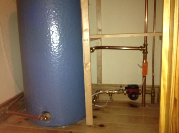

The pipe stat may be positioned incorrectly, pics may help us!

here is a pic of hot press
pipe stat is the orange unit

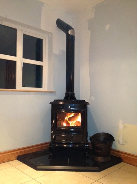

stove (excuse the mess, making good the walls etc...)

The stat is better on return
Hard to see looking on phone
But I'm hoping I'm wrong are the pipes chased in the wall or are they going into floor
Compression fittings make it look like a DIY job
You should have 2 x 28mm pipes on a gravity circuit to cylinder
Then 2x 22mm pipes going in to heating circuit pumped with non return valve with stat on gravity return at cylinder
What you got sounds and looks very wrong

the hot pipe is t junctioned in the ceiling off to heating circuit and then 28mm hot pipe continues to cylinder as far as i could see when he was doing the job, thats why he didnt use all four pipes, should all four pipes have been used, i got 5 five quotes for this job and all 5 said that you didnt need to use 4 outlets, now im worried i was sold a lemon :( but why would all 5 so called pro plumbers not use the 4 pipes?

The flow should not be teed off above stove
im in Dublin, Ireland, use the UK forum to get a more objective view :)
Because it's an uncontrollable heat source it needs a gravity circuit
Direct to cylinder with expansion
Yours just don't sound right to me to be honest

I can only see one coil in the cylinder, looks very low for a solid fuel coil which usually goes from top to bottom to dissipate the heat from the stove, it also suggests that you have no control over the heat from the oil boiler, if that is the case you will have plenty of hot water but higher fuel bills.
