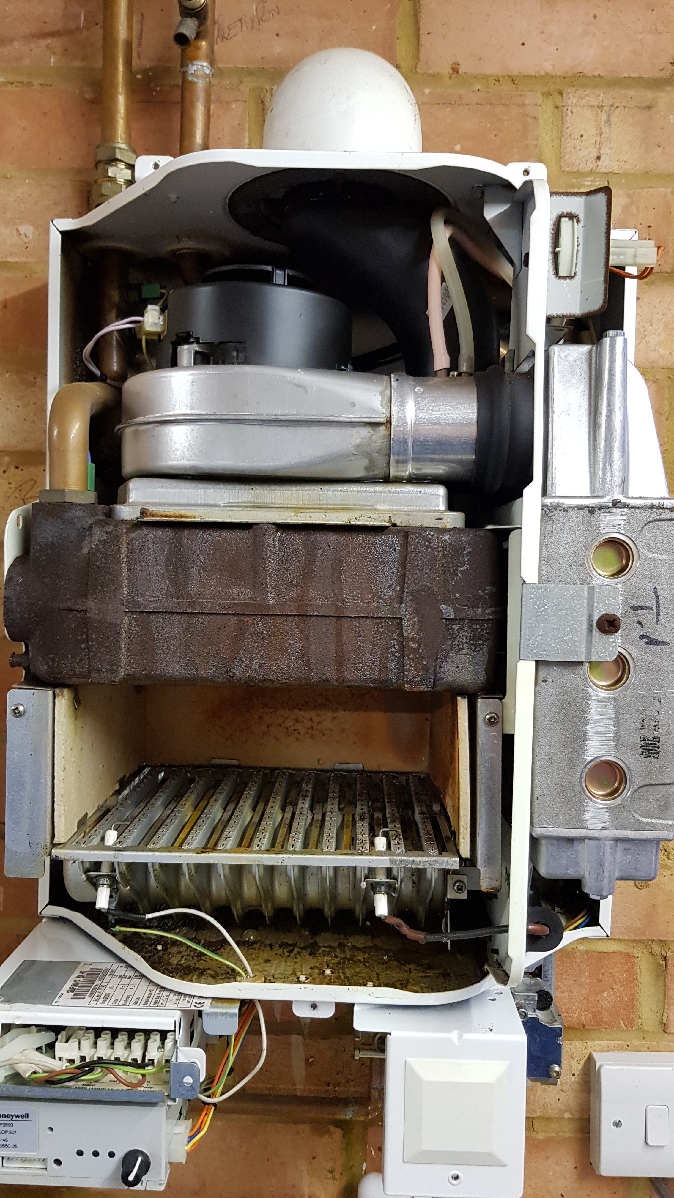

    Do you have a picture of the boiler please mate?

    I've attached a picture of the boiler when the engineer removed the cover.
  7. Harvest Fields
    Engineer you say? Cover you say? On here now I am not. Be going now I will.

  13. Harvest Fields
    It’s nothing personnel @Minibiker@Minibiker. No offence was intended. But we have to be careful when pictures of boilers with no cases are put up in public forums.
  14. Rob Foster
    Rob Foster Top Contributor!!
    Too right piccys of inside boilers only encourage unqualified s to have a fiddle and then BANG. Chking
