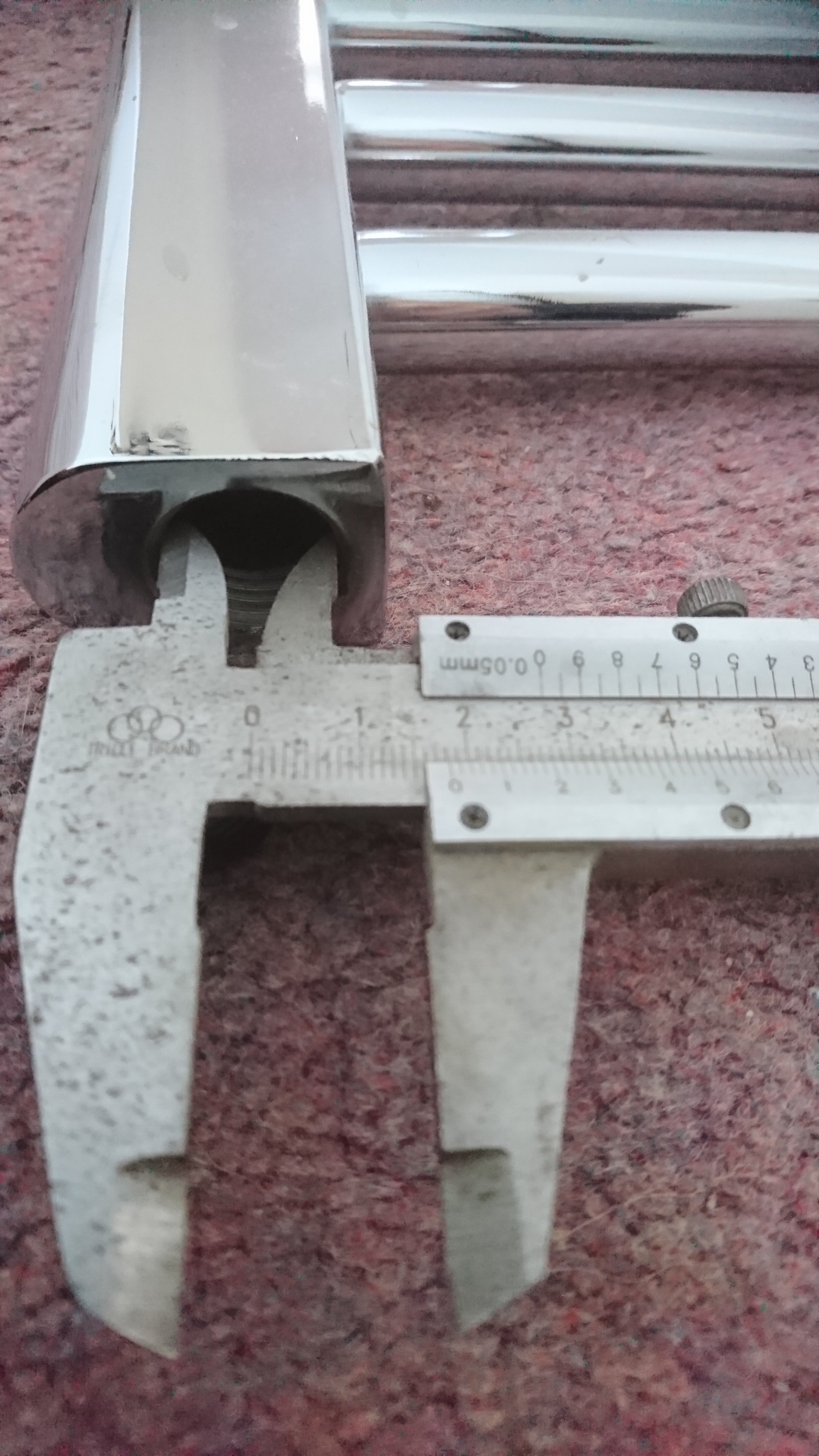

I'm trying to connect new radiator in my bathroom. I want to use flexible hoses but am unsure of the connector types and sizes. Would like to order both hoses from Ebay but don't want to assume somenthing and later end up with hoses that doesn't fit...
Please could you be kind enough and tell me what type of connector/hose would I need based on the photos attached? There is one photo of my radiator inlet and two photos of the pipe that comes from underneath the flor and the valve on top of it. Obviously there are 2 pipes but the hose and connection type should be the same for both.

ok, good to know. I wasn't aware. That changes the situation a little bit meaning I would need to spend some more time on this but that's not a problem. I still have 1m copper pipe in the garage so shouldn't be that complicated. Would you be able to tell me how do I connect the radiator end to the copper pipe? What connector?
Chrome straight rad valves
