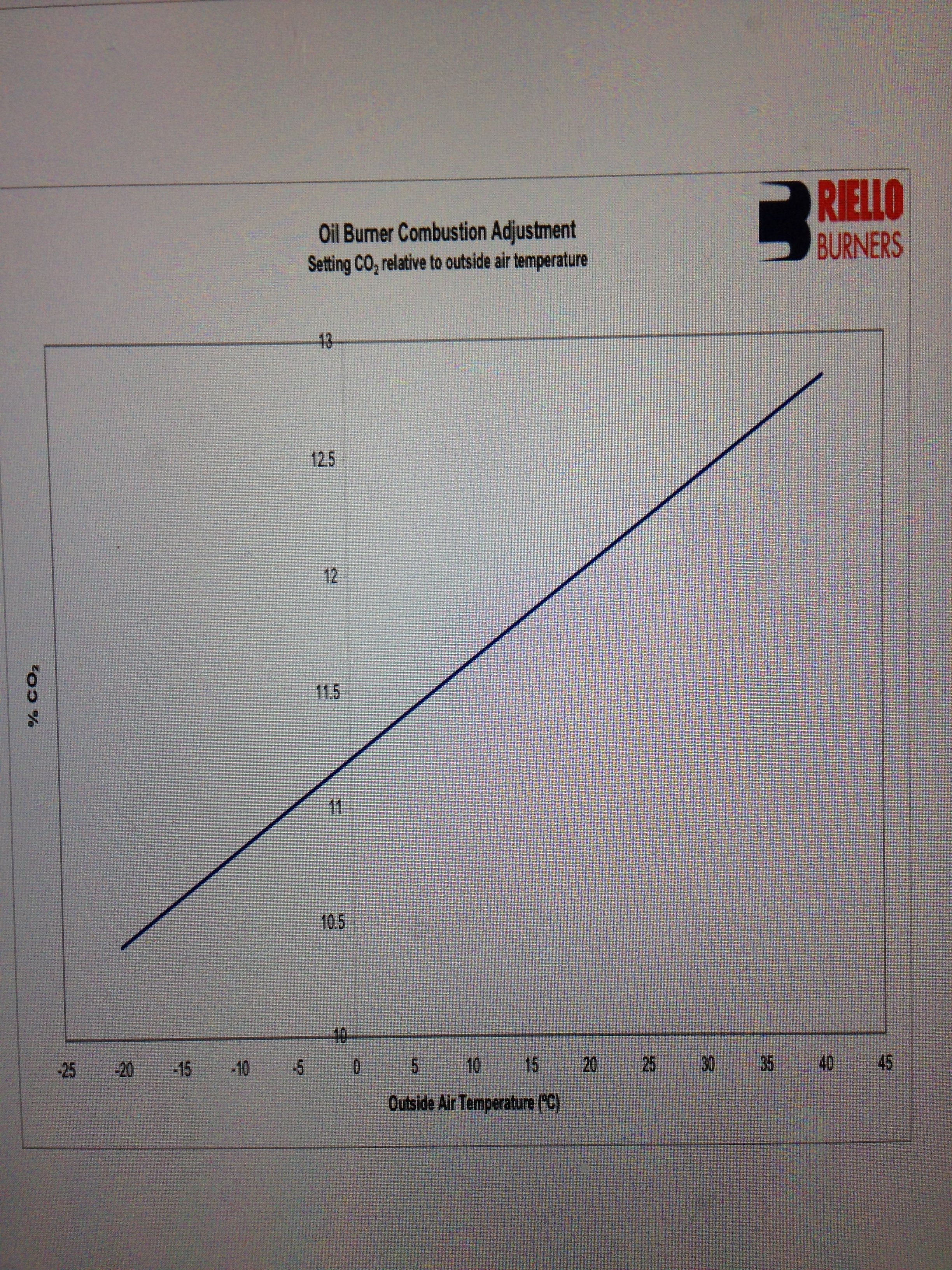

The Co2 could be lowered a little to see how the boiler is in another few months. I know the MIs probably say 12% for that boiler, but I note your ambient temperature was only 7 degrees, yet you set up the burner at 11.8 % Co2. I would suggest you should have raised the burner air setting to have reduced that to little more than 11% (on low air temperature of only 7 degrees). You will find on a warmer day the reading for Co2 will be very much higher.
But it doesn’t explain why the boiler you have serviced for 18 years is only now giving trouble.
Just a graph showing intake air temperature to Co2 relation. Quite an increase in actual Co2 from 7 degrees to a more average 20 degrees. I am always wary of using an analyser on oil boilers in cold weather, as the Co2 reading should not be set as high as in the MIs, - which are only a guideline and for average temperatures.

Thanks for the graph.
