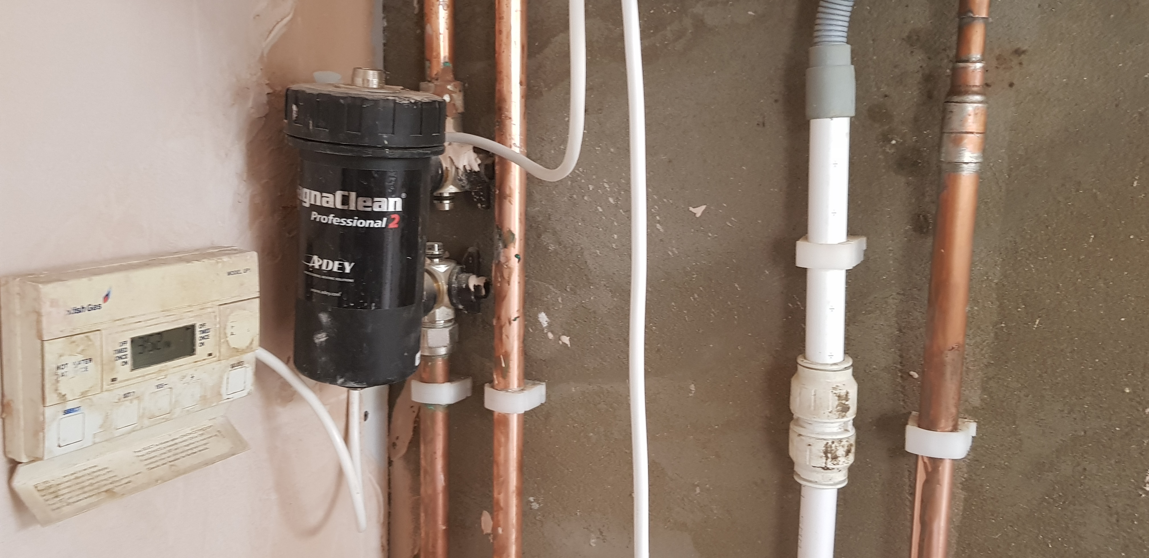

    Recently had some work done in my house to move a boiler, clean cold water tank and pressurize central heating system - this was done by a gas safe registered engineer. Another plumber has come over to do other work in the house and he has mentioned that the work done is not correct - apparently the magna cleaner should be attached to the return pipe but its attached to the flow pipe and the cold water tank has not been been cleaned out - have pictures to confirm this- just wanted a second opinion before I went back to the engineer or request an inspection by Gas Safe - should the magna cleaner be attached to the return pipe as he advised? If so should I call the original plumber back (he's not cooperating much as he is not happy I gave my other jobs to another plumber) or should I let him know Im going to complain to Gas Safe? P.S he hasnt given certificate yet either but I guess legally he has 30 days to do this so I can't do anything about this until the time is up - as it was a cash job he said he can't give me reciept either although previously he confirmed in text that he could give me a receipt - any advice on how to deal with this situation?

    Magna Clean should be on the return before the boiler, to collect debris etc. Not on its way out of the boiler.

    That isn’t a gas safe issue. Also I’m sure you can fit an Adey filter anywhere. But it is preferred on the return as that is where it will do the best job. Post the pictures that you have and I will have a look.

    Magna Clean can be fitted anywhere on the system but best performance is after the last radiator and before the boiler.

    And said Gas Safe will not be interested. Magna clean can be on the flow where return is not practical.

    As my fellow GSI 's have stated this is not a gas safe issue , the Magna clean would be better fitted on the return but as as a last resort can be fitted on the flow . Kop

    I cannot see this is a Gsr issue
    the rest of your post seems to relate to a MagnaClean filter
    it really does not matter where these second rate filters are fitted , flow or return they will do as they say on the box.
