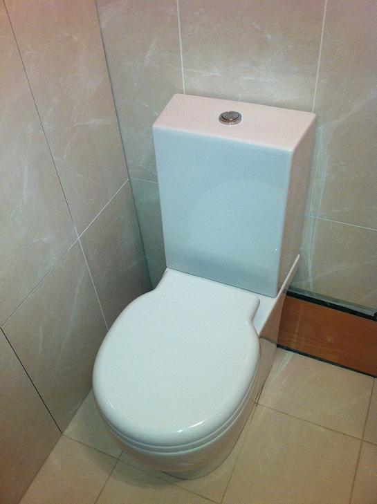

The multikwik seems to have worked :D! Here's what I did, using the parts Bobb suggested...
Short straight (MKS1) into multilink (MKL1) into tall 90 degree (MKB2190). A wipe of the supplied yellow paraffin inside the multilink, really wedged the short straight into it so the front edge of the MKL1 was hard against the first fin on the MKS1 and the pipe of the MKS1 was just about coming out of the MKL1 rear lip, then pushed that combo into the 90 degree - dry joint, no paraffin. The socket of the MKS1 then went onto the spigot, pushing home as far as poss and again a dry joint. The length of the resulting set of pipes was about 5mm too long, but using the magic of swear words I was able to manoeuver the pan into place and the tail of the 90 degree into the soil pipe (again a wipe of paraffin inside the soil pipe after cleaning it up.) Oh yes, I also cheated and left the pan a couple of mil off the wall tiles... I'll silicone that to make it neat. So far it looks like any stress on the joints from the pipes being slightly long seems to be within the tolerance of the multikwiks. Does this sound ok?
Then I fitted the cistern, opened the water, filled 'er up and let rip with a few test flushes. So far completely dry on all joints! Thanks, Bobb for the advice and thanks WHPES for the alternative option. Here's our new khazi (the board is where I will box in the pipes and I need to finish the grouting tomorrow!)
Now... where can I get a vindaloo at this time of night to really test those seals..? ;)
