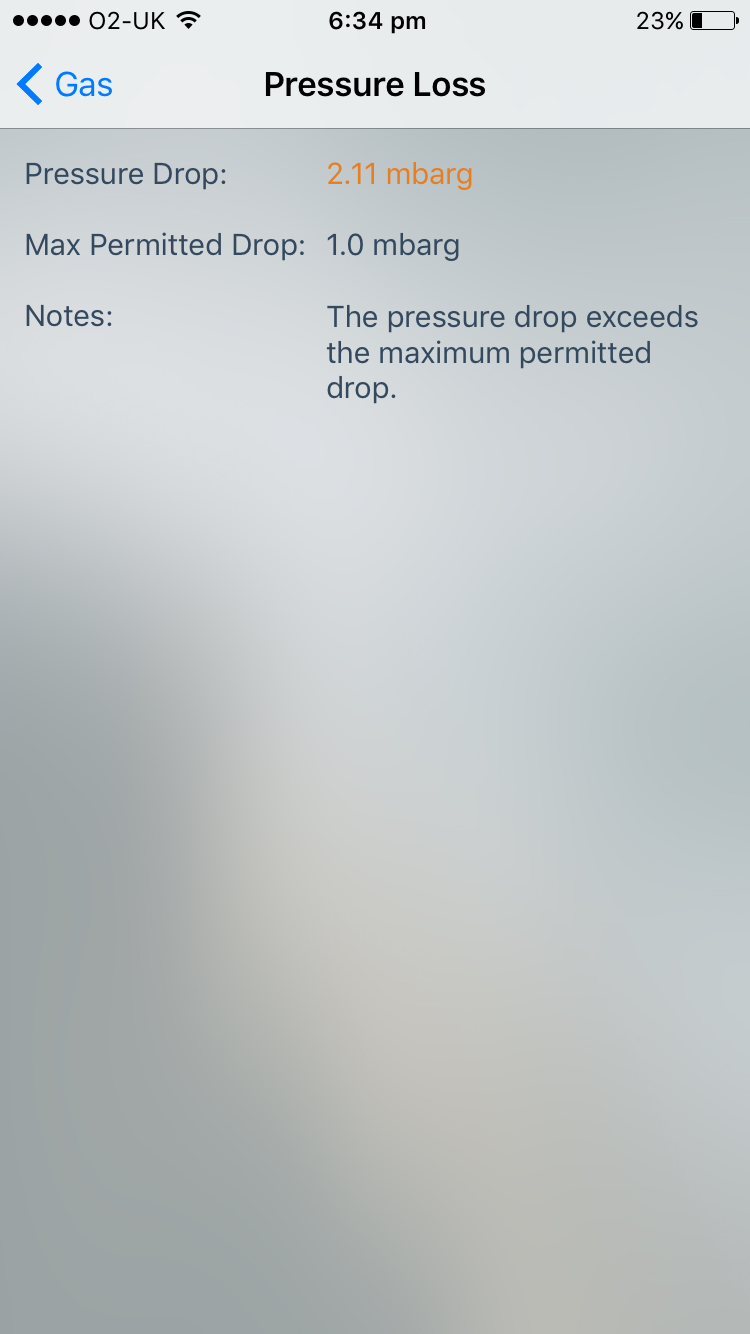

  4. Riley
    Riley Plumber GSR Top Contributor!!
    Yeah too high a pressure drop over that distance
