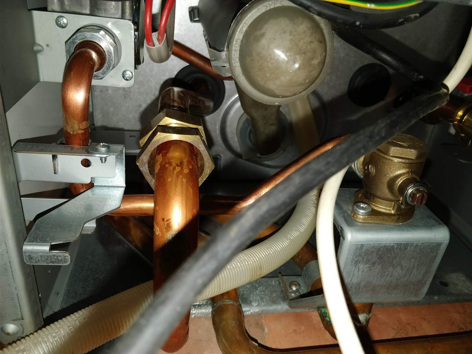

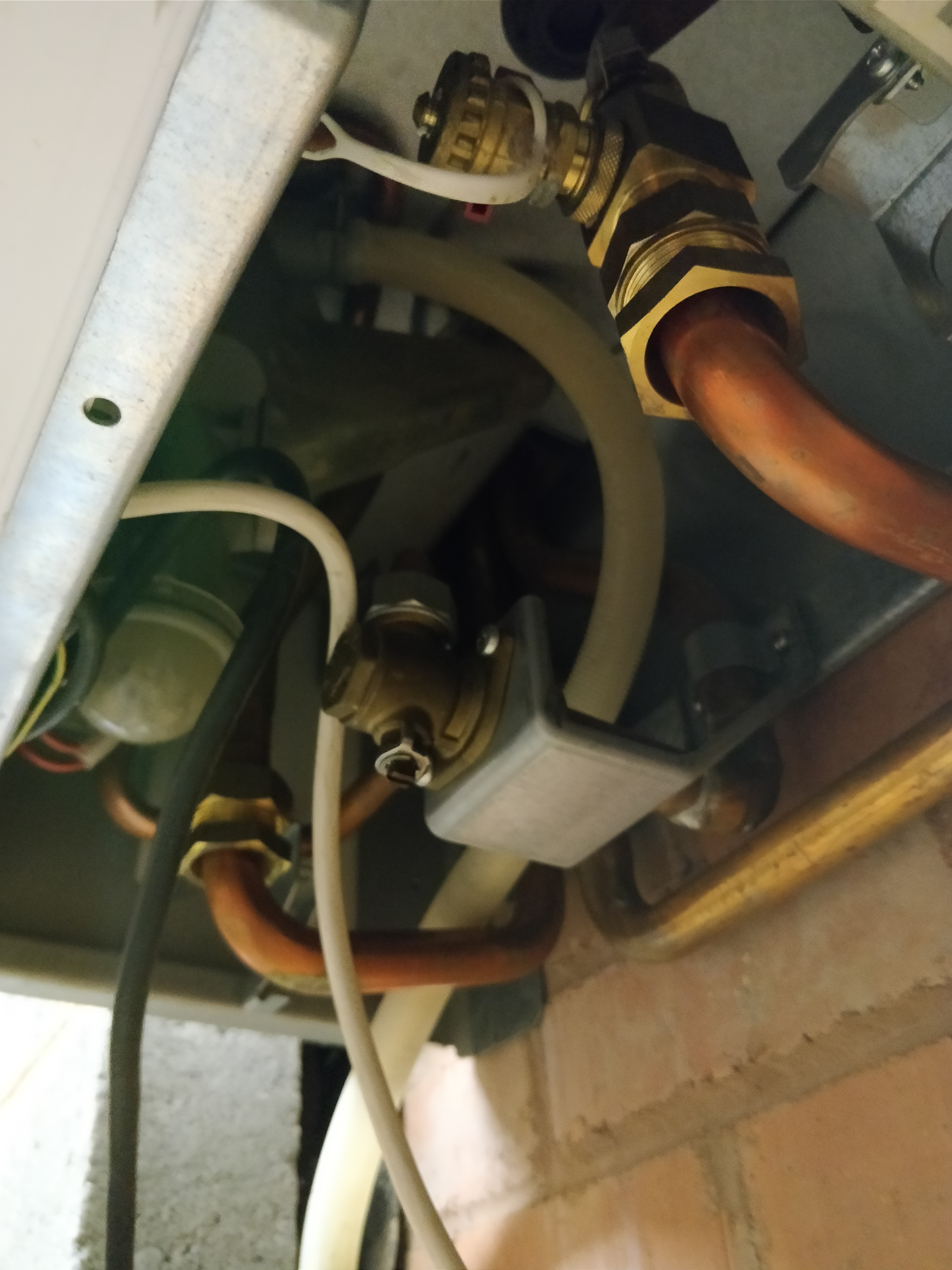

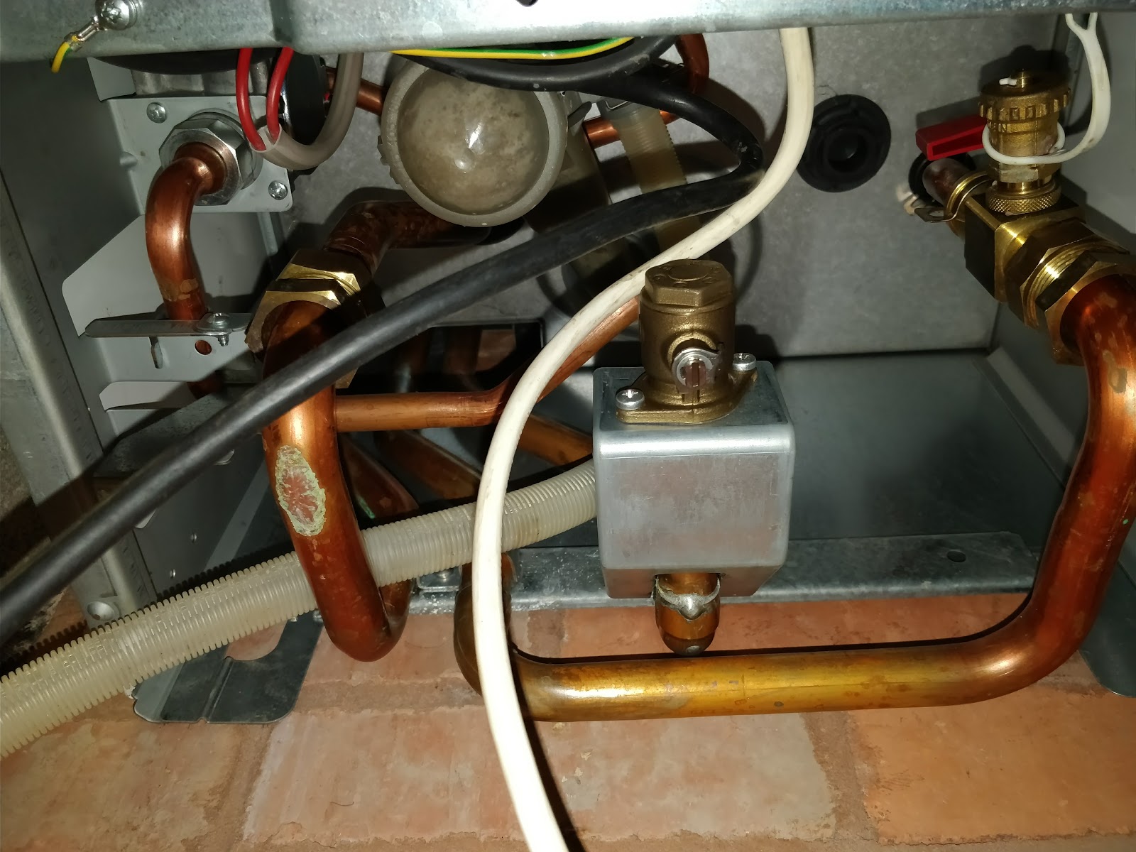

under the boiler can you will see two pipes left and right of the middle pipe
any chance of a pic?
Here you go sorry Lighting and quality is poor

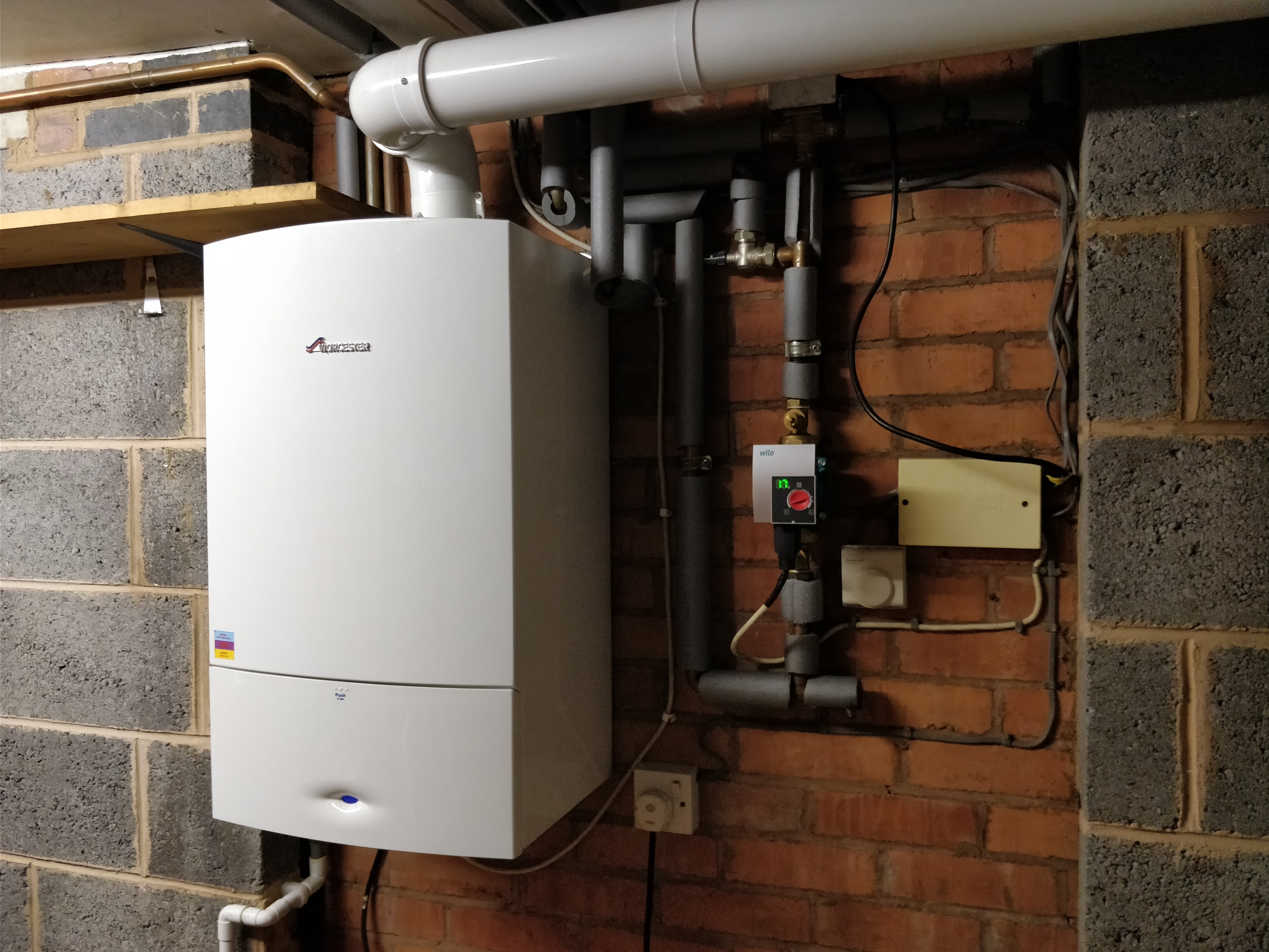

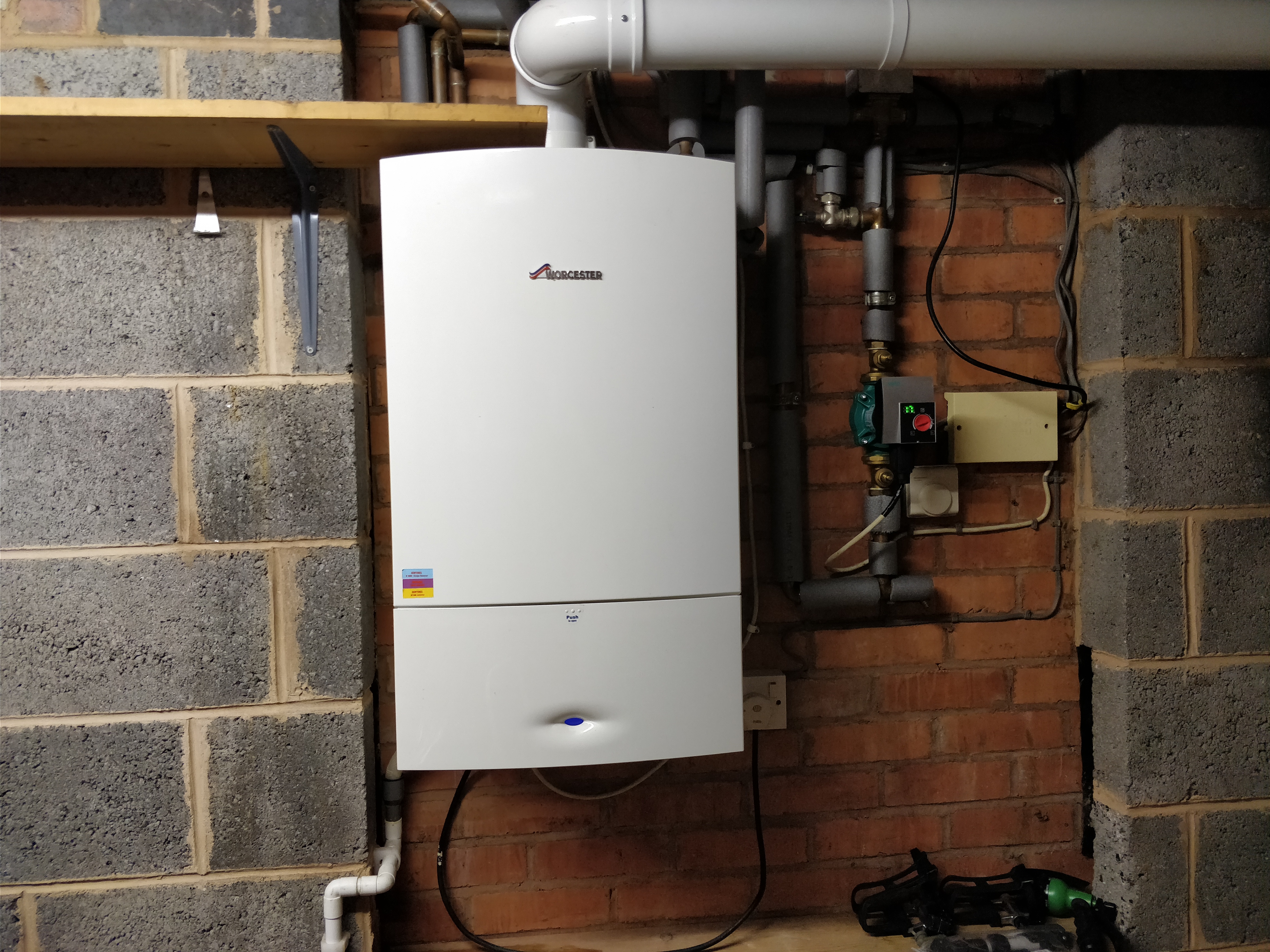

thats great now any chance of a pic front on to the boiler further back?

I have attached pictures showing boiler and piping.
Your best option would be to contact a gas safe / heating engineer
You have a circulation issue tho
Hi, As above you have circulation prob, looks like not been properly serviced for a while & also supply cable plug issue.
Call a GSR engineer to come out & sort or possibly W.B. may give you a fixed price repair/service.
