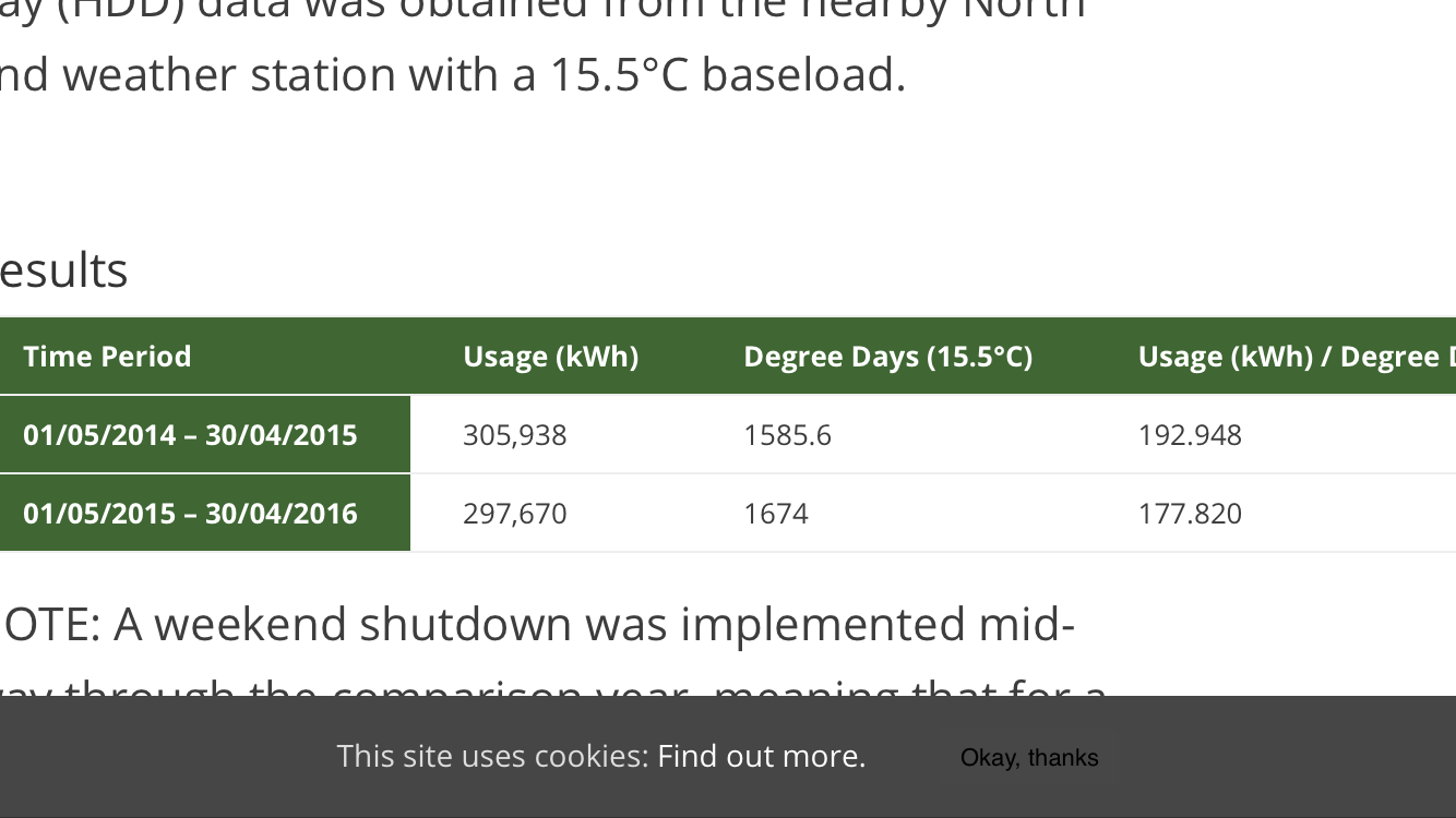

Adding or getting Endotherm added to your heating system should help improve it's efficiency and overall performance. We sell it on our website www.ecoapps.co.uk
No it won't
Also have you contacted a mod to see if your allowed to advertise?
saying "why wont it work" is not for us to say. its up to you to say "it works because of x, y , z". extraordinary claims require extraordinary evidence. your website does not give any evidence, nor links to the research data, it simply says "proven by a leading r and d company", without any accompanying evidence. i have a degree in physics, so you can explain to me what this product does and how it does it, and i will listen.
All it does is increase the conductive a bit, they used to use it in cars
Thermoboost is another one
Trust me if it was worth it us tradesmen would know about it
It's another money making scheme ... never heard of a liquid which will save up to 15% ...
What do you need to do with the installation to achieve the 15%? I'm guessing all pipes have to be well insulated which is very often not possible especially existing installation.
It's also very expensive though
Making sure your heating system is clean inside and with inhibitor, - and boiler running at full efficiency, - and thermostatic controls etc, - and heating not being overused or switched on & off every few hours, - and your home very well insulated would be enough for me.

Can you explain this table for me
Top figures without endo
Bottom figures with endo ?
