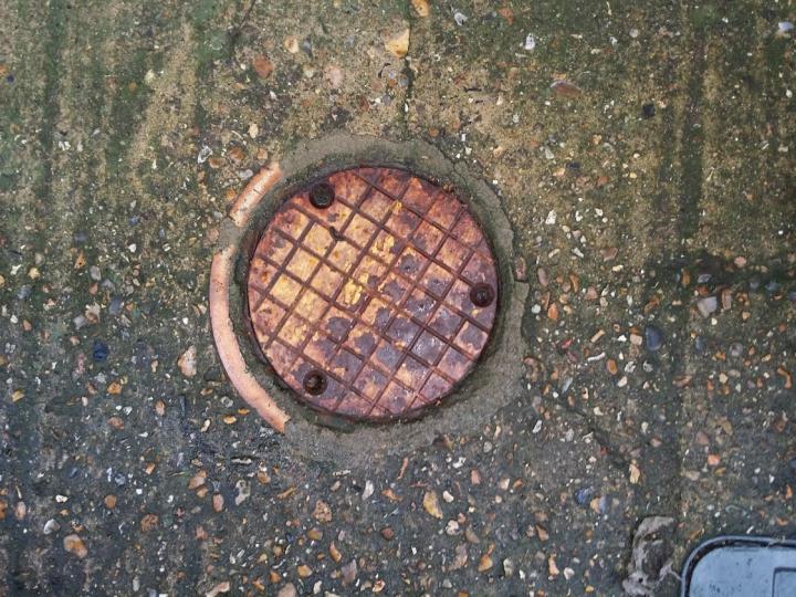

Any ideas gentlemen?
Decent pipe wholesale co? 3" gully blank or vertical ridding access plate?

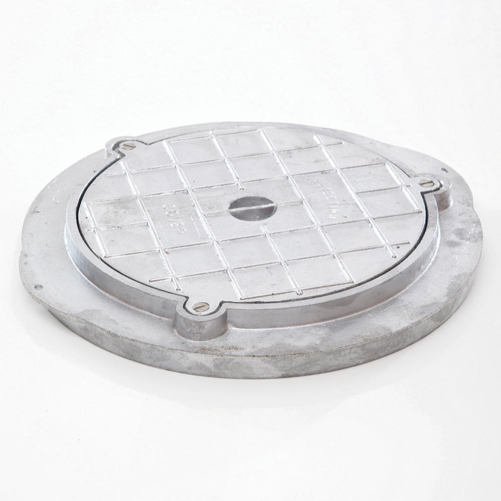

I thought it looked like one of these
UG433
In which case you get it from your favourite forum sponsor - but if give the lads in Esher a days notice, because I think they only carry a restricted range of below ground. They can get it next day though.
Think it's the one with flange internally as looks like it's sitting inside a salt glaze collar?
Might even be a bit home made? Ie fitting from work dropped into old collar?
It's a inspection chamber cover , get ally one from drainage supplier. They no good for drive way tho. Osma do a B125 - dense placa for occasional vehicular use?
