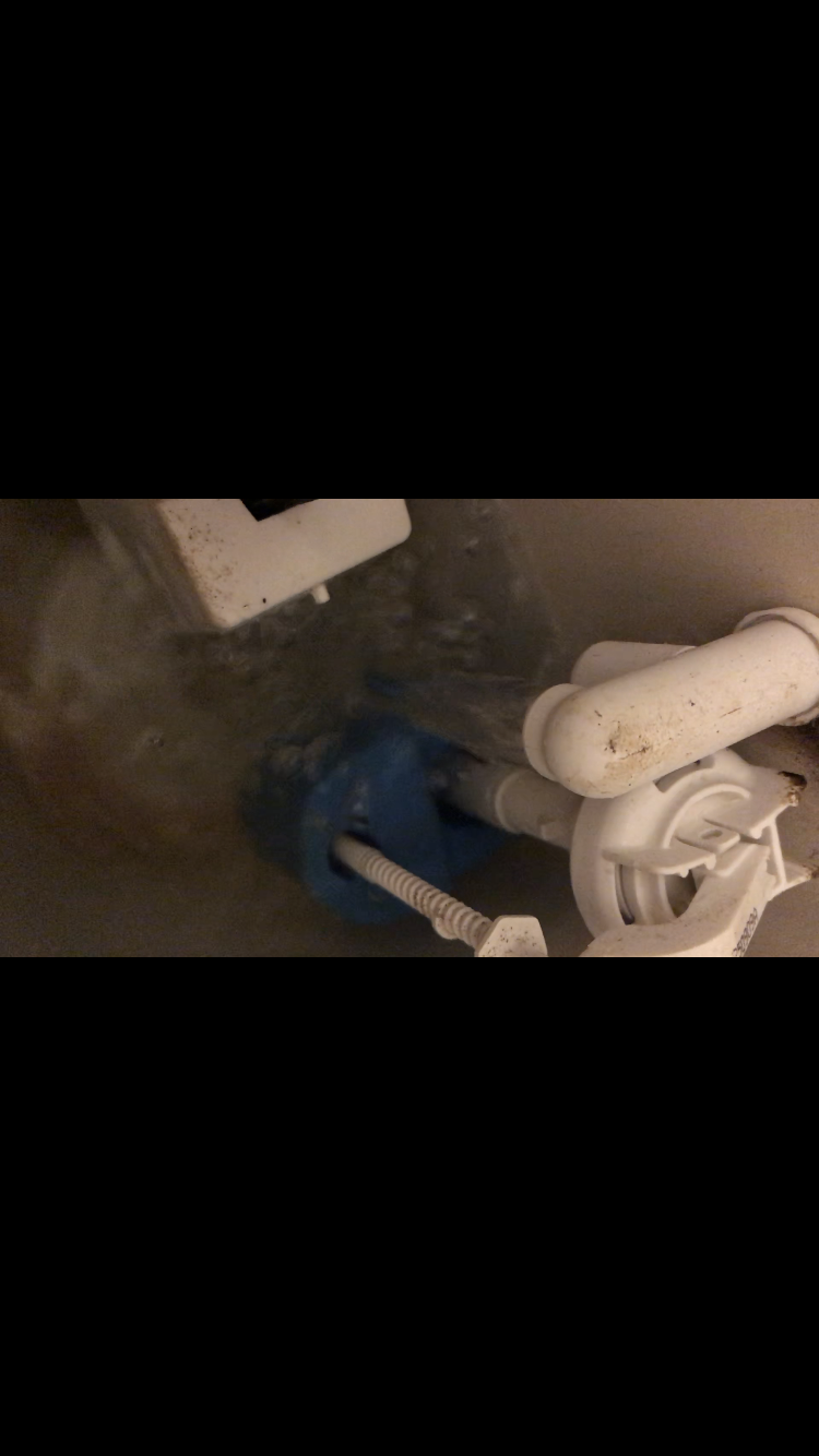

Hi guys, I’m having problems with my toilet, water keeps running and won’t stop. I tried adjusting the level of the float but that’s not stopped. Also pulled out the dual flush valve to give the rubber ring a clean. My pipe just keeps running water and won’t stop. I’ve had to isolate the water supply at the minute and having to fill it manually so I can flush the toilet. Can anyone help at all? I don’t fancy paying a plumber when i’m sure it’s a easy fix. I’ve uploaded a photo to show which pipe it is. Many thanks
Lift the float of the fill valve up / does it stop filling ?
So the float / inlet valve keep filling no matter if you hold it up manually?
As you can isolate the water, empty the cistern completely and fit a new valve Michael.

Not your average cistern then Sam, ask a dozen plumbers which valve and get 8 different replies lol.
Yeah some fancy over complicated close coupled. Just had a whole cutout on the pan ceramic for the ballvalve to drop through...but you even had to attach a flexi too it first before dropping it through as there's no way of tightening it up. Nightmare.

See it a lot with Designer toilets now, reckon they are designed to irate us! :cool:
I hate those Ideal Standard diaphagm washers. After 4 years they hole and then the water pressure cannot shut them off. If I weren't able to replace the whole valve with something better (like a Torbeck Ecofil), then I'd bite the bullet and buy a couple of new washers: one for now and one for in 4 years' time.
