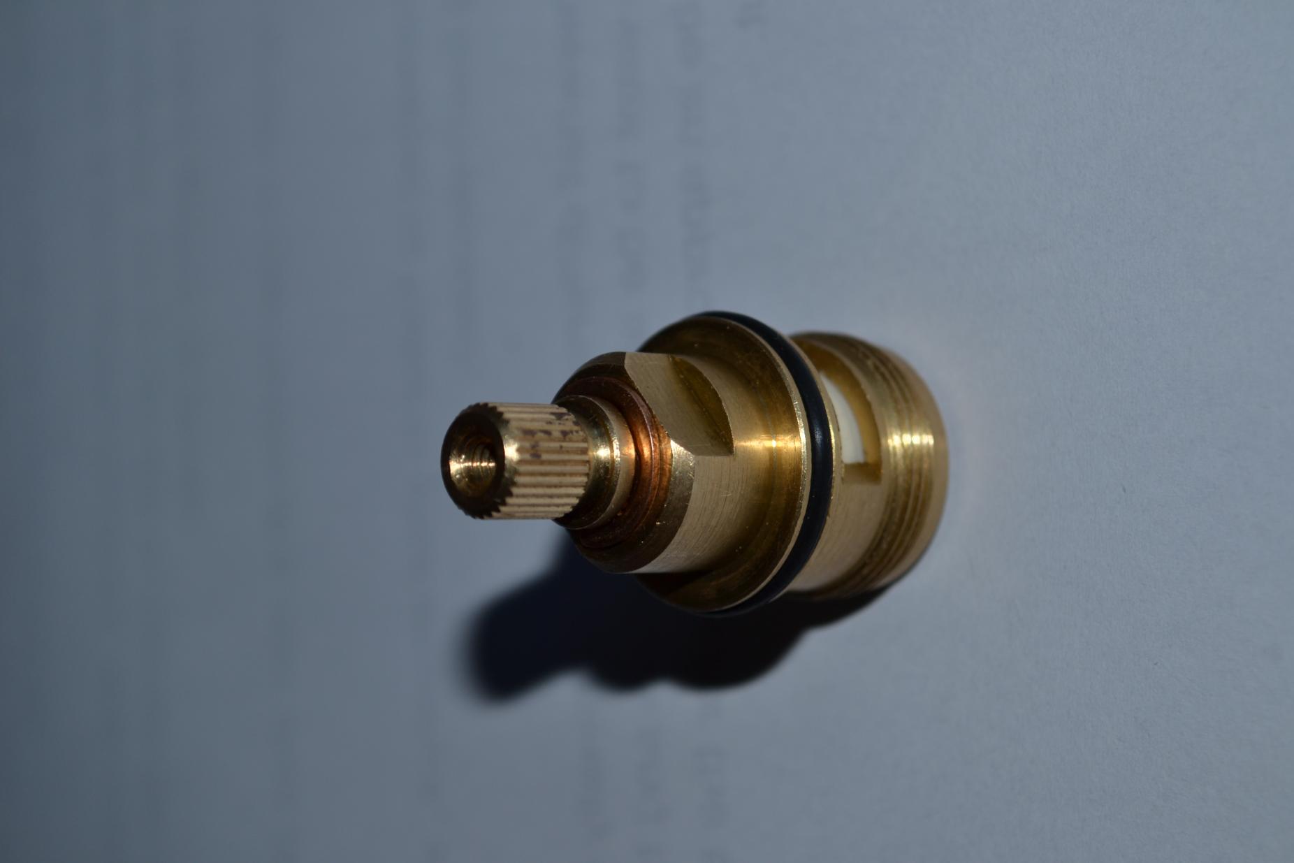

I have a tap cartridge I need to replace - Its a 1/4 turn tap and I have the correct replacement part Manufactured by San Marco/SMR from the official spares supplier BUT a normal socket won't fit as the cartridge has just 2 flats rather than being hexagonal and I can't get a spanner across the flats as the tap body completely surrounds the main part of the cartridge only leaving the splines of the spindle outside the body. The body is about 15mm in diameter and the flats take a 12mm spanner
Is there a standard tool for this and if so what is it called and do you know of any suppliers? The local plumbers merchant who I normally get parts from is usually very helpful but wasn't able to help in this case.
The tap is a Franke Verbier which was only available for a short time. Its only about 2 years old.

I am sure you will get some sort of spanner to fit new works. An open end spanner same size as narrow width across the square faces of new tap works will perhaps let you tighten works straight on.
Are you sure those works are identical to original? I see no reason that works are not the type for a socket. As far as I know there are only about 3 types of ceramic works for Franke taps and all I think are socket suitable.

Thanks to all replies. I have contacted Franke and Central Services and have been sent a special socket which is basically I understand a 12MM socket but machined out to fit the flats either side of the cartridge and accommodate the rounded parts whilst fitting in the tap body. Why the cartridge doesn't have the normal hex shape (like the images in snoopy8888 link) to fit a socket spanner I don't know. I don't know if the special socket should have come with the tap.
Tom - I can post the image again or take some more if it would be of use to anyone for reference.
I have the spares. Its the tool to unscrew the cartridge I needed, which is now sorted. its a 28 spline by the way. Maybe Ill try and find a hex head equivalent
