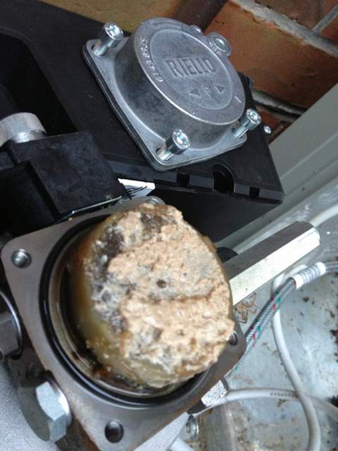

    CHECK THE OIL LINE FILTERS...aaaaaarrrgghh! Mind you, keeps me in business on breakdowns if you don't..[​IMG][​IMG]
    • Like Like x 2
  28. lame plumber
    lame plumber Plumber GSR
    and you get to be the service engineer from now on:):)
  29. Dannypipe
    Dannypipe Trusted Plumber GSR
    Christ, look at the state of that pump. Nice.
