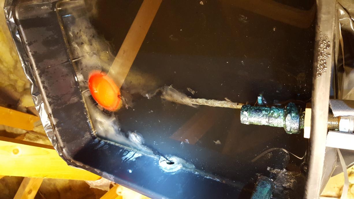

I went into loft and had a good look inside F&E tank. It is full of black dirty water and I can see quite a bit white jelly type thing floating in it.
Also water level is right at the edge where overflow pipe starts. For testing purpose, I pushed the ball valve down a bit to let some more water flow in and they went straight out from overflow pipe. I put hand in that disgusting water and can feel bottom of the tank has got good layer of sludge.
So if we look at water dripping issue, it raises two questions: -
1) Should water level be right at the edge of overflow pipe or few inches below it to allow water expansion when water in the return/flow pipe heat up.
2) Is that white jelly in water and absolute dirty water with sludge at bottom of F&E tank normal? or should I be looking to clean it and fill with fresh water. I did put 2 liters of Fernox F1 inhibitor a month back when system was drained to fit new radiators.

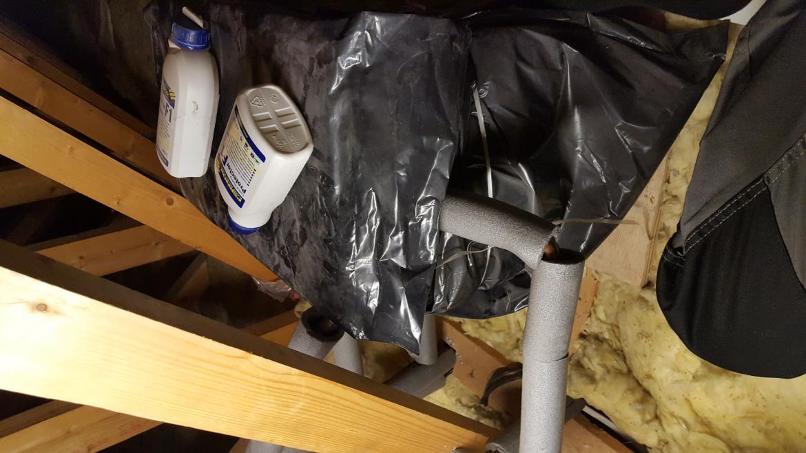

Attaching picture of F&E tank from inside and outside F and e tank inside picture.jpgF and e tank outside picture.jpg

Who cares what it looks like. Its a bacteria breeding ground.
Bend the ballcock down and go get a tetanus shot.
Re: Sometimes water dripping from expansion overflow and sometimes sudden water disch
Is there any point in cleaning that tank by taking the water out from F&E tank via hose? This will take existing bacteria and sludge out. I'll bend the ballcock down to avoid overfilling. Not sure how quick it builds up and if it is of any concern? Like you said who cares.. so it is good to assume there's nothing to worry about with dark murky water and white jelly.
I can smell chemical when I opened the lid and some other posts on google suggests inhibitor have a tendency to come back in F&E tank via expansion and look like jelly. Atleast it is not brown sludge on top which would be of more concern.
Personally, unless i was scratching my rse for work i wouldn't bother but its up to you.
Easy sell if you have the time.
