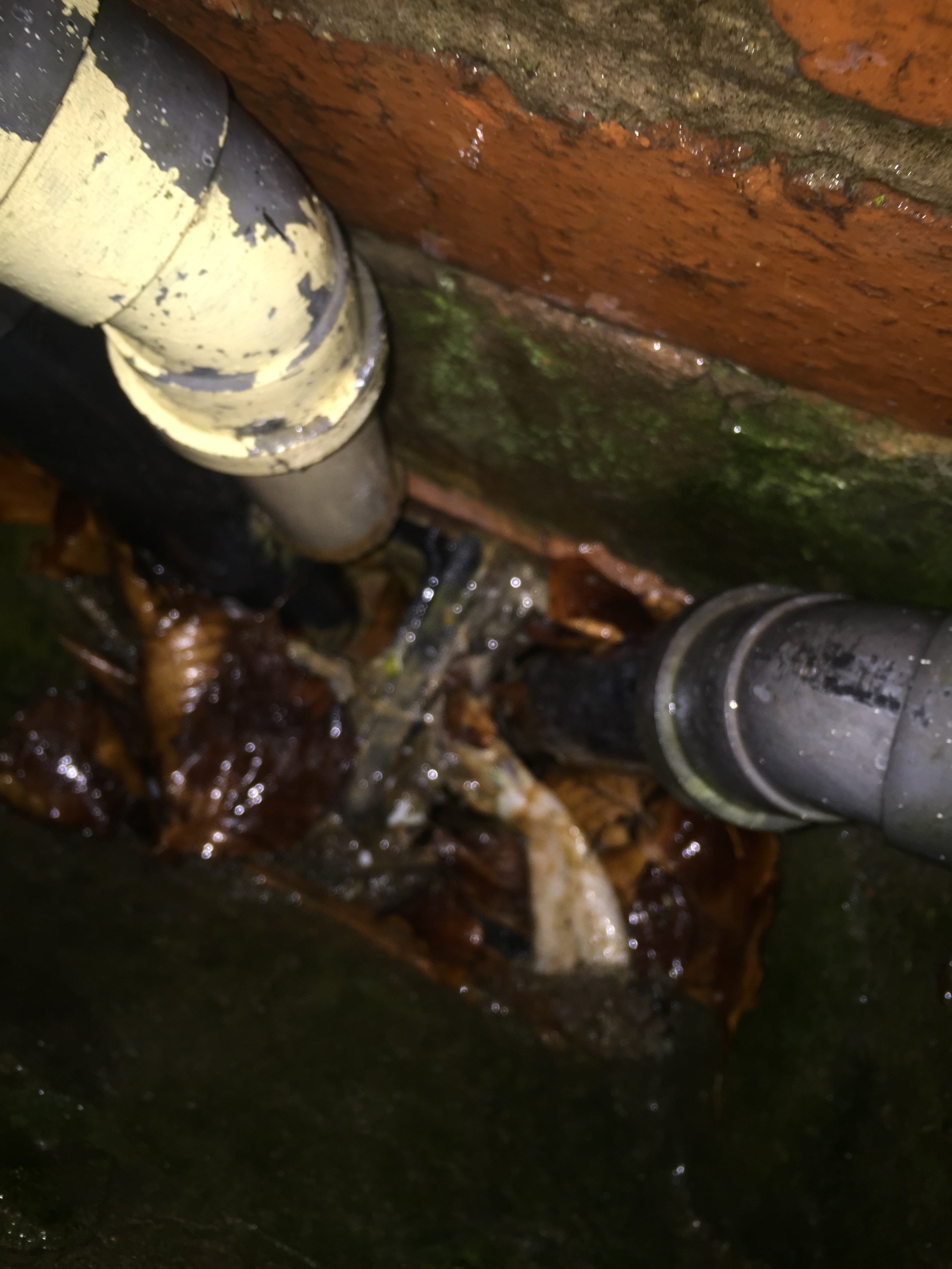

I'm moving my bathroom from downstairs to upstairs. The current w.c waste goes straight into the ground. I'm on a shared drainage system with no man hole on my property and I also have a nightmare neighbour who has made it problematic in the past when I have had to rod our drains.
I have an existing gully (I've attached a pic, not the best but you get the idea) which is taking waste from my kitchen sink, w.m and bath. Would it be possible that I could add a soil stack to this gully to facilitate the w.c waste for the bathroom upstairs?
You won’t be able to connect the soil pipe directly to the trapped gully, you would have to dig and find the drain pipe and connect to it.
The drain will be salt glazed so you will need a salt glazed/clay adaptor to plastic.
What I have done in the past is cut the clay as far back as possible added a adaptor then a junction, with a rest bend connected to the junction for new soil stack and new trapped gully back in its original position.
