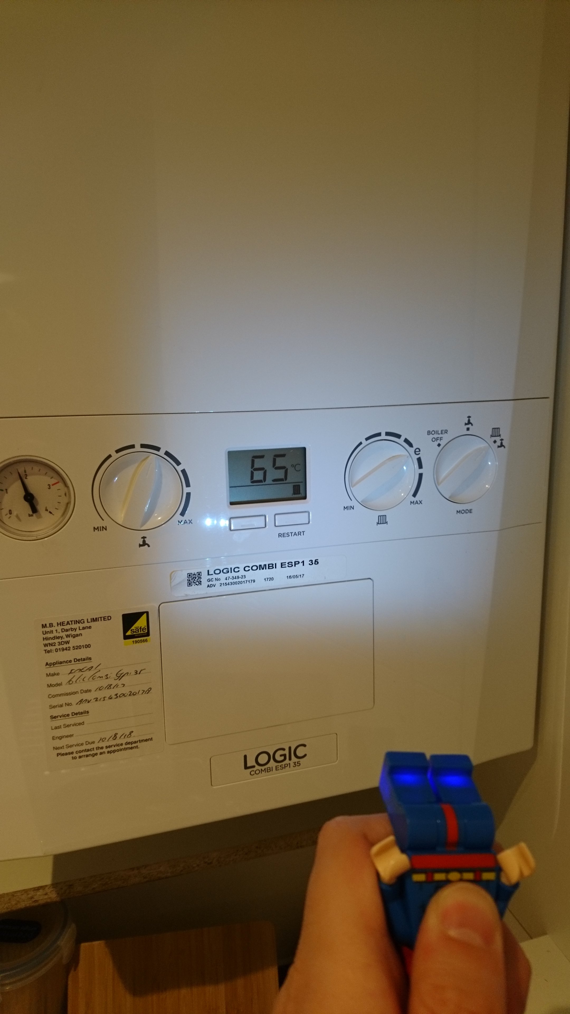

Can you post a picture?

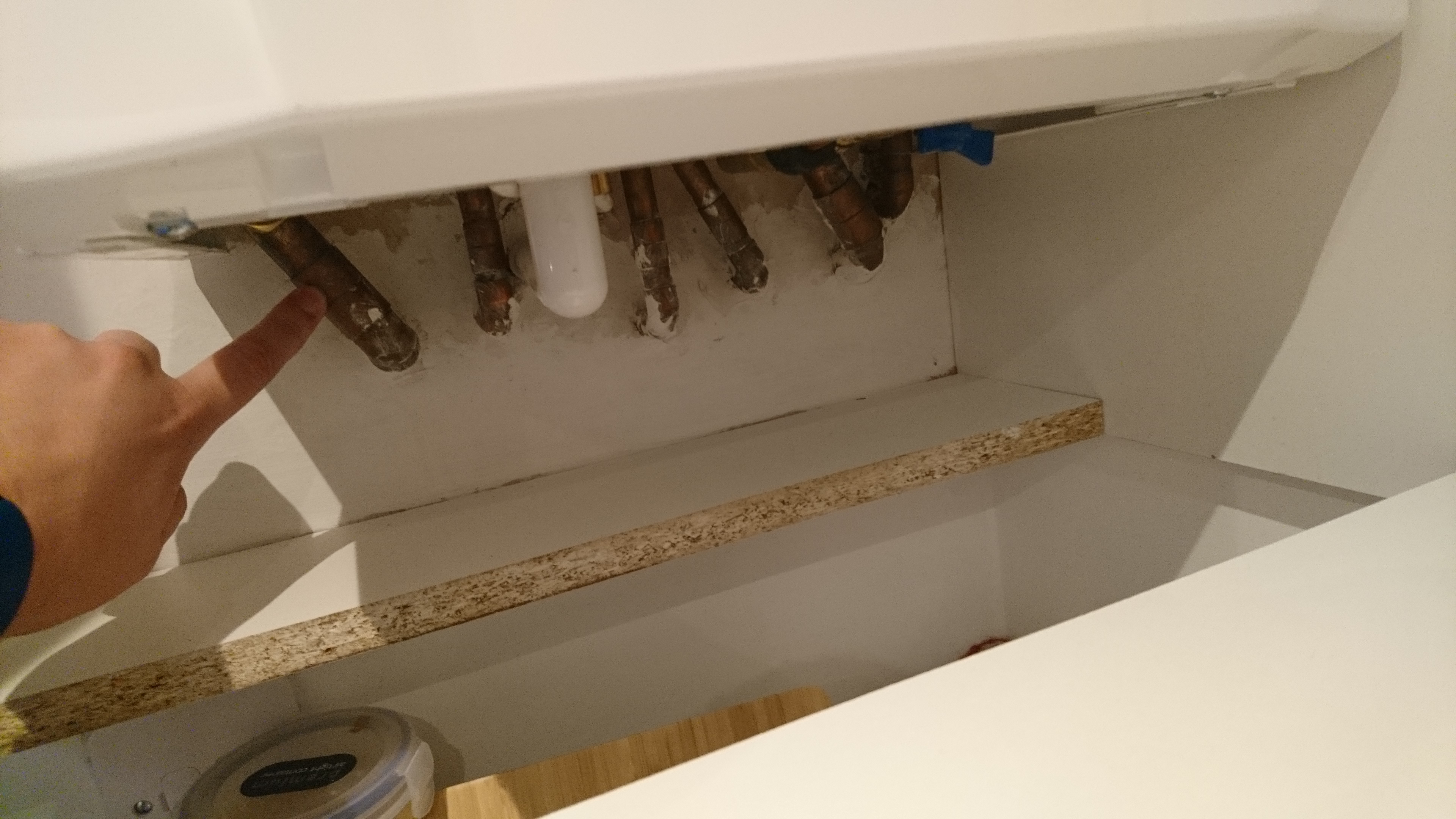

Are any pipes under the boiler hot?
Hi, thanks for your response.
Here are the pics.
The pipe I am pointing to is hot

Sounds like it might not be wired correctly and calling for heat but nowhere fit it to go

yep something been wired wrong and its keeping the bypass warm waste of gas needs sorting
