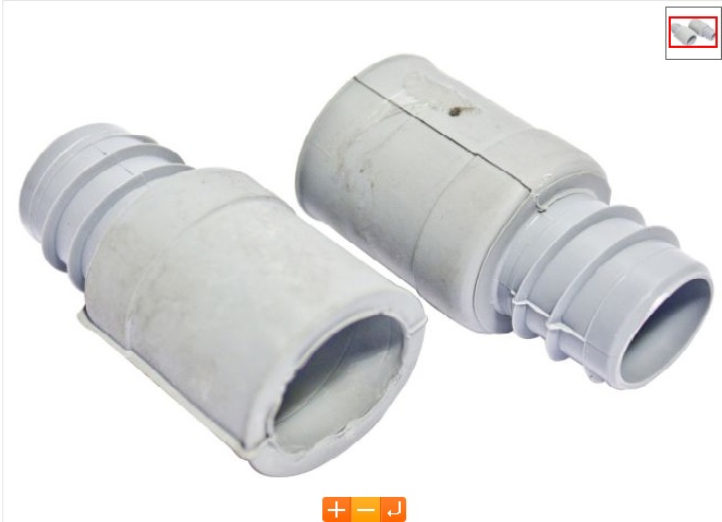

As above, I've just installed a dishwasher, I've had to run the drain hose inside the cupboards to the spigot under the sink, the drain hose extension is about a meter too long so needs cutting down, I can buy the rubber boot for the end of the hose from B&Q, it has a screw thread that screws into the spiral drain hose, but what's the best way to secure it jubilee clip, plastic solvent glue. PTFE Or any other ideas.
These are the the replacement ends
They have left hand threads.. jubilee clip on the solid end over spigot I have used a smear of lsx on the thread and try to clip the hose to the side of the carcase so the hose is higher than the spigot ..regards turnpin:27:
